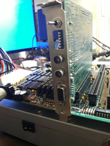

Hi
i can't find information of this card "PRECISE" - CHIP "PARADISE PVC4 38307C"
9 pin output
if is a ega cga card can i use this converter
LINK -> https://www.ebay.it/itm/Arcade-Game-RGB-CGA-E … 7Cclp%3A2334524
for testing (i have only vga monitor)
    368.88 KiB
    196 views
Reply 1 of 10, by Benedikt
The Paradise PVC4 is a combined CGA+Hercules chip. The CGA part supports the Plantronics ColorPlus extensions for 320x200 16-color and 640x200 4-color graphics, as well.

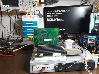

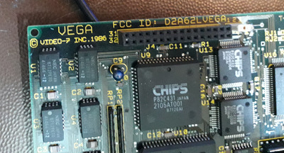

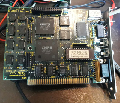

Reply 6 of 10, by dataino.it
I tested this "VIDEO7 VEGA" and no lucky
no signal on RCA connectors
computer give me 1 long beeb , and then start , no signal
on pin 9 of db9 i have ttl signal of 59.6 HZ and on pin 8 a 15.7 Khz

Reply 7 of 10, by Benedikt
Hardly surprising. That one is clearly an EGA card. The RCA jacks on EGA cards were typically feature connectors for optional add-ons, not composite video output ports.
Reply 9 of 10, by Predator99
Benedikt wrote on 2021-03-09, 21:27:
I noticed I own almost the same one, #12 here
EGA Video cards - BIOS image collection
If yous doesnt post play with the DIP switches...switch one after one or compare with the config of my card.
