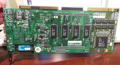

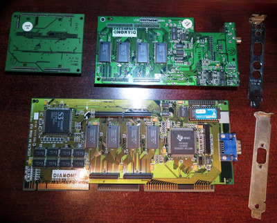

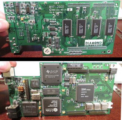

I recently was able to source one of these very rare MPEG-1 decoder and capture daughter cards for my Diamond Stealth 64 VRAM VLB graphics card, which is based on the S3 Vision 968. I found it on a Diamond PCI graphics card. Unfortunately, VLB and PCI cards have different orientation with respect to how the daughter card mounts, so I could not use the PCI's slot bracket. I had to make my own with some hand tools.
The Diamond Stealth 64 VRAM VLB normally resides in my AMD Am5x86-160 build along side a SCSI Adaptec AHA-2842A VLB card. To use the MVP-2000 daughter card, I had to remove my existing 2 MB VRAM upgrade module, but luckily the MVP-2000 comes with 2 MB onboard so I can keep my existing 4 MB of VRAM. I figure this combination pretty much makes for the ultimate VLB graphics card.
I remember user Elianda also has this combination and ran some tests on it a few years ago, however I cannot seem to find the thread. The main difference being that he ran his tests under Windows 3.1 and I am using Windows 95c and NT4. Does anyone have experience with the MVP-2000 series decoder card in Windows 95? According to elianda, I need to use a media player which is able to use an MCI device. I currently have Windows Media Player 6.4 installed. Does anybody know which versions of Windows Media Player, or perhaps an alternate media player, would be able to use an MCI device under Windows 95?
I'm also wondering if anyone has the PDF manual for the MVP-2000? I've been unable to find it online.
Were there any 3rd party Windows NT4 drivers for the MVP-2000? Diamond clearly stated on their website (wayback) that they have no intention to create NT drivers.
Some photos:
1.97 MiB
2019 views
1.94 MiB
2019 views

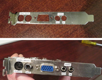

More photos showing it mounted and making a custom slot bracket.
1.63 MiB
2012 views
541.05 KiB
2012 views
Reply 2 of 54, by Warlord
i couldn't of done any better making a bracket. hard to imagine at one time MPEG 1 was considered permissible. that's when we thought VHS was good. but even still SVHS or LaserDisc going through a high quality comb filter still looked much better to my eyes than any low res mpeg 1 I ever watched.

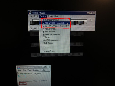

I'm still setting up the drivers for the system, but elianda didn't think that WMP 6.4 allowed for MCI. Do you know which versions do? Not sure how well Windows will take to downgrading my WMP version.
EDIT: OK, it appears that Windows 95 already comes with Video for Windows, so I don't need to install that like I would for Windows 3.11. It also looks like the original Windows Media Player for Windows 95 is still installed on the system (mplayer.exe), even though WMP 6.4 (mplayer2.exe) is also installed. WMP 6.4 doesn't have the option to use the MPEG-1 overlay, but the original WMP for Windows 95 does show these options under the Devices tab from within WMP:
1 Overlay-Diamond
2 MPEG Video - Diamond
3 CD-MPEG Video - Diamond
4 ActiveMovie
5 ActiveMovie
6 Video for Windows
7 Sound
8 MIDI Sequencer
9 CD Audio
I can open an MPEG video and select the device 2 MPEG Video - Diamond. The video plays fine and consumes 22% CPU, whereas if don't use the MPEG DIAMOND option, CPU usage is 99%. The problem is that after about 10 seconds or so, the computer freezes up and I need to hard reset. I have noticed that the S3 86C968-P chip gets pretty darn hot once the system has been up for 15 minutes. My IR gun shows it as 61 C. Perhaps the heat is causing the system to freeze when using the MVP-2000? Or maybe this temperature is in the normal range for this IC?

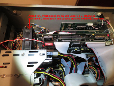

Reply 6 of 54, by feipoa
I think I have resolved the issue with the hang-ups. I believe they are caused by overheating, however I'm not sure why I had the issue on my system, but elianda didn't. Perhaps because I'm running the VLB bus at 40 MHz, and he was running it at 33 MHz. The solution I found was to add a fan just outside of the VLB cards. It solved the issue with the case off. I haven't tested it with the case on yet. But the S3 968 chip was getting up to 61 C without the fan; with the fan it stays under 30 C.
Before adding the fan, I had tried to set the capture device IRQ to 14 and the graphic card's IRQ to 9. Didn't help. As a side note, should these two IRQ's be the same?
Before adding the fan, I tried running the resolution at 1024x768x16 instead of 1280x1024x16. Didn't help.
Here's the fan. I zip tied it onto the bottom of the HDD bay.

Here are the settings you should see when you open Windows Media Player for Windows 95. Click on Devices. This option is not present with WMP 6.4.
48.31 KiB
1884 views

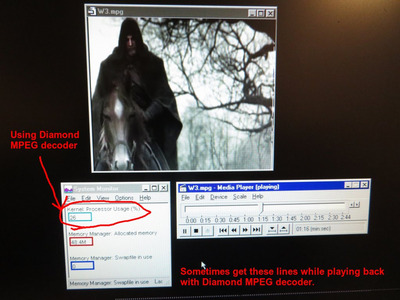

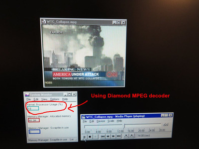

Here is a screenshot using WMP-95 with the MPEG decoder. Notice the CPU load.
99.83 KiB
1884 views

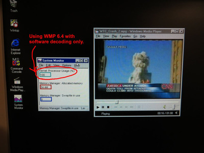

Here is a screenshot using WMP 6.4 without the MPEG decoder playing the same video. Note that I can also use WMP-95 to play the video in software mode using ActiveMovie, but the CPU load is the same as with WMP 6.4, that is, at 100%.
98.31 KiB
1884 views
Here is another screenshot playing a different video. This video was created by user elianda using the MVP-2000 on his system. Note the dashed lines which appear at the bottom of the screen. These sometimes, but not always, appear when playing videos. Perhaps related to the 40 MHz FSB? I suspect this MPEG card was targeting mostly Diamond's PCI version of the S3 968 running at 33 MHz. When you look through the manual, there is no mention of using a VLB card except in the addendum sheets.
121.9 KiB
1884 views

Here is a better photo of the dotted lines which appear after about a minute of playback. The longer the playback, the more rows of dotted lines. After I close the player, I can move a window, any window (e.g. the file explorer), over those dotted lines and the dotted lines will be gone.
141.32 KiB

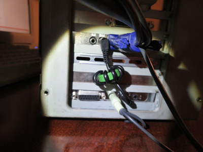

The manual also mentions to use a ferrite bead on the audio cable. The box comes with the cable and ferrite, but I don't have that. Anybody have any idea the dimensions of a core I need to use and how many wraps? I've connected just whatever I had in my bin to the cable as such:
56.06 KiB
1878 views
EDIT: After putting the case on, I still get crashes when using the MVP-2000 decoder card, but the crash didn't occur until 5 full minutes of playback. With the case off, I could play indefinitely. When I measured the temperature of the S3 968 chip, it was only at 38 C. Not sure what else I can do to fix this with the case on. I suspect this MVP-2000 wasn't designed to work at 40 MHz. I'm not sure which component is the component that is causing the crash at temperature. Perhaps something in the BIOS would help? I'm using an Asus VL/I-486SV2GX4
142.88 KiB
1862 views

I remember this kind of ferrite parts attached to the cables.

Reply 14 of 54, by feipoa
Hypothesis is supported, that is, the system does not hang when using a 33 MHz FSB. To use this at 40 MHz, sufficient airflow may be required. I had no issue at 40 MHz with the case off and a fan blowing at the card. Maybe someone else with one of these cards can share their experience w/40 MHz?

Reply 16 of 54, by feipoa
But will be interesting none-the-less.
33 MHz - no more crashes, even with no fan and S3 968 at 62 C. artifacts still present after prolongued playback though. The artifacts can be removed by maximising any window, then minimising it again.
40 MHz - needs fan and case off for no more crashes
40 MHz with case on + fan = crash after 5 minutes of playback. 5 minutes gets extended if I leave the heater off in the office. I haven't check exactly how long yet. Will do this tonight. elianda sent me a whole mpeg movie at 320 x 240 to test on this system.
In reality, most videos of the time weren't longer than 5 minutes so I can live with 40 MHz + fan + case.
