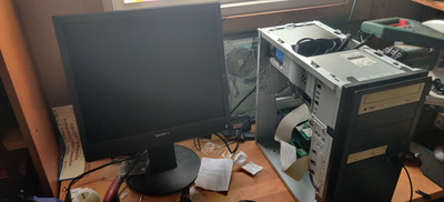

Cool I got the motheeboard cou and ram for 75 $ or something labeled socket 7 prolly seller did not know what it was. Neither did I really it seems so I am considering myself lucky indeed!
I read somewhere the board might take 1gb of ram which is silly. I might go with 256 or something like that if I find a good deal. 64 is prolly fine?
This is just fun and games for me atm, something to do when kids and wife are sleeping and I need something to tinker with. I do feel I'm getting a little obsessed though.. 😁
I want a case that is more period correct at least.
