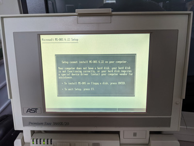

I have an AST Premium Exec 386SX/20 laptop with a faulty old Conner CP2044PK hard drive that no longer boots. However, trying to boot from a MS-DOS 6.22 floppy disk is not working. The floppy drive does not seek and when I boot the system with a disk in the drive and run Setup to set the date and time and all that, I get this screen every time and there is seemingly no way past it.
Do I just have a dead floppy drive or is there some other reason for this? I've tried both the "Use Floppy First" and "Use Hard Drive First" settings in the setup and it makes absolutely no difference.

Reply 6 of 11, by EvieSigma
I was able to get it to boot off a floppy disk by disabling the hard drive in BIOS (setting the hard disk type to None) so it does seem I'll need a new hard disk solution to actually use this laptop, as I can't boot off a floppy at all with the hard disk enabled.
Reply 7 of 11, by EvieSigma
So after a LOT of troubleshooting, I finally figured out the problem, and I'm embarrassed at how simple the solution was.
I noticed that if I set the hard drive type to "None" in the BIOS, the machine would boot off a floppy disk just fine. But that of course meant I couldn't use the hard drive.
So I checked the spec page for the hard drive (a Conner CP2044PK) and I noticed the jumper section, so I checked the jumpers on my drive...and my drive wasn't jumpered correctly for single drive/master operation!
Once I fixed that I was able to install MS-DOS 6.22 to the drive without issue, I'm embarrassed that I didn't check this sooner as I could have probably had this computer fixed months ago.
