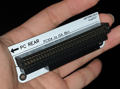

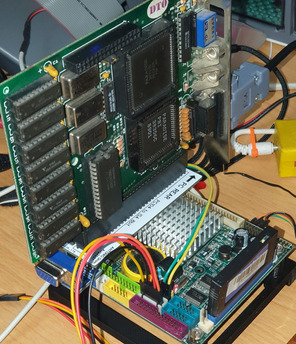

Reply 162 of 912, by shimart
I made a simple pc104 to 8bit isa converter.
Fortunately, the 8bit EGA card works well.

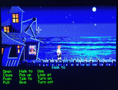

Secret of Monkey Island 16 color mode.
119.72 KiB
2385 views
Shoot to the screen with RGB2HDMI (RPi0) converter.
