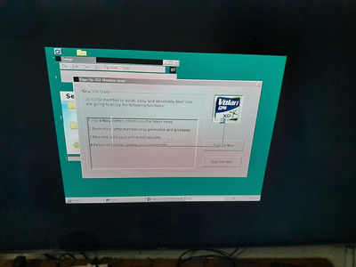

Reply 710 of 912, by Duffman
I've got some rather glitchy looking graphics with some XGI driver hacking.
1.47 MiB
1262 views

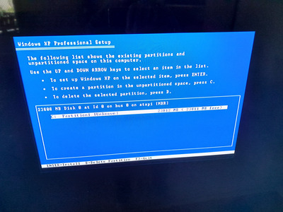

Reply 711 of 912, by Duffman
Something I noticed when booting up XP's installer.
1.87 MiB
1234 views
It's also getting the SD card size wrong.
So even if I did somehow manage to backport XP's ATAPI driver to 98SE we'd still have issues.
I know you won't want to hear this, but I genuinely think we've got a hardware issue here. I don't think ICOP's SD card circuit calculates the SD card size properly.
@rasteri @Nachtrave
If you're able, Can either of you try and hook up one of these onto the weecee for testing to see if it works?
https://www.ebay.com/itm/291873933509

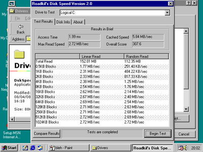

Reply 713 of 912, by rasteri
Duffman wrote on 2022-12-30, 06:35:
Just tried it.
This gets rid of the yellow marks in device manager, but doesn't really increase the speed much (2.7MB/sec instead of 2.0)
I think this proves that it isn't a driver problem.
My uninformed theory is that the particular access patterns that Windows 98 uses just aren't suited to SD cards for whatever reason. Possibly it could be a sector-offset issue or something like that.
    19.1 KiB
    1206 views
    18.99 KiB
    1206 views

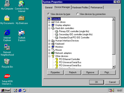

Reply 714 of 912, by Vridek
rasteri wrote on 2022-12-30, 12:10:
Just tried it. […]
Just tried it.
Can you please post how you did it? We have similar results except my Cached Speed is now 214 MB/sec. And Max Read Speed is 4.26 MB/sec

Vridek wrote on 2022-12-30, 12:30:
I just plugged an SD-to-IDE adapter into the IDE port of another vortex86DX board that I have.
