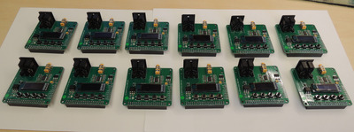

Reply 69 of 178, by dreamblaster
OK, started making more MP32L now ...
Also 3d printed enclosure design is making progress ...
    886.68 KiB
    1537 views
Thanks for your support !

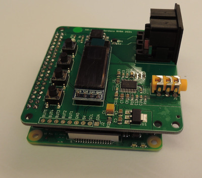

Reply 70 of 178, by dreamblaster

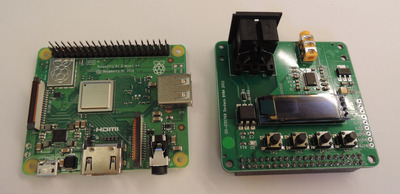

Combining with PI 3A+ which is about same size
will also make a smaller enclosure for this combo.
Here's a demo of MP32L + PI3A+, playing DOOM E1M1 (general user soundfont) : https://youtu.be/PCfqzXE_fU0

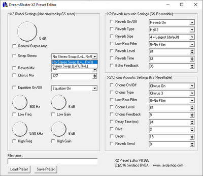

Actually with the preset editor you can set up to swap L/R on the X2
17.09 KiB
1436 views
This preset can be uploaded using the X2UPLOAD tool.
keep in mind, for X2GS, the different preset addresses.
(this belongs in X2GS thread rather than here) --> if more questions on X2, please put in the right thread 😀.

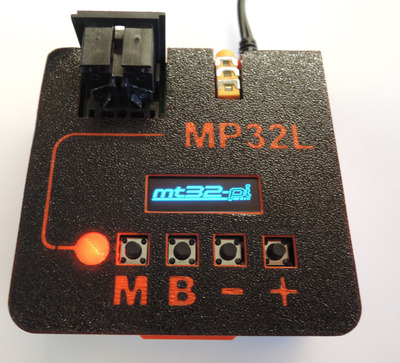

Reply 77 of 178, by dreamblaster

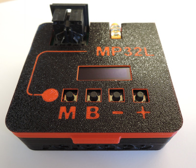

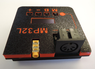

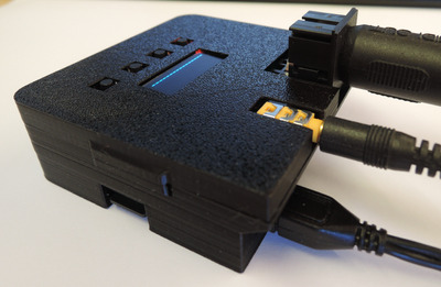

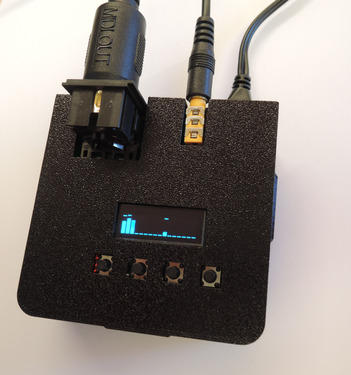

PI3A+ MP32L enclosure prototype... still needs some adjustments, and some color...😀
Reply 78 of 178, by dreamblaster
Here's the next iteration, with color and led shine through, and tolerances adjusted...
Starts to look good ?
