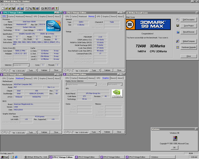

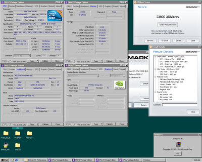

4.89GHz E8600, meet my 5.00GHz X5690 with a surprisingly 98 friendly Asus P6T motherboard. Working SATA ports in AHCI mode (thanks to RLoew), Intel PCH chipset drivers ported to 9X (thanks to LoneCrusader), fully functional USB 2.0, PS/2 and floppy ports, and even a 98 compatible 1Gb/s NIC. It has its quirks but it's functional enough to daily if I really wanted to, not whiled OCed so hard like this though.
OCing this was a PITA. It took days (of free time) of trial and error to get the RAM and Uncore stable. While the RAM/Uncore are five repeat 3DMark01 runs, P95 (only 1 hour), and Memtest86 stable, the CPU is not. CPU is just stable enough to run 3DMark99, 01, and 03 once. I actually had to crank up the CPU voltage a bit for 3DMark03 to get the Mother Nature test to finish. For some reason, while I was testing in XP, it would finish with a lower voltage than 98 would. I would never daily this machine with the voltages I used to get the clock speeds I did. I haven't optimized the memory timings at all either, it's all just set to what XMP would have set it too. The 7950 GT is also not OCed at all, except for the factory OC. It has a considerably lower clock than a 7900 GTX though. 570MHZ vs. 665MHz. These 98 benchmarks are really CPU limited. With only 1 core enabled, the CPU temperature was not a concern.
Specs
CPU: Intel Xeon X5690
Motherboard: Asus P6T
RAM: Kingston HyperX T1 6 GB (3 x 2 GB) DDR3-2000 CL9 (KHX2000C9AD3T1K3/6GX)
GPU: XFX GeForce 7950 GT (PV-T71J-YPE7)
Clocks and Voltages
CPU: 5GHz - Core: 1.525v, PLL:1.88
CPU Cooler: Cooler Master Hyper H412R
BCLK: 200MHz
RAM: 2005MHz - DRAM Bus: 1.8v
Uncore: 4009MHz - QPI: 1.4375v, IOH: 1.2v, ICH: 1.2v
GPU: Core: 570 MHz, Memory: 730MHz (Stock)
1 core active, HT disabled, LLC enabled, spread spectrum disabled

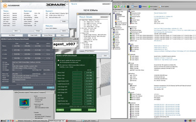

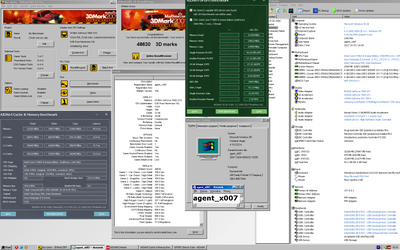

I still prefer my Madness PC (WAY more versatile and far less deadly to components) :
412.04 KiB
2048 views
492.53 KiB
2044 views
More here : LINK

I could definitely find a lower stable overclock with more sane voltages, but where's the fun in that? Like I said, I'd only use these voltages and clock speeds if I'm benchmarking something. Which, after beating baguete's score, I don't plan on doing.
Your Madness build was actually a big factor in me choosing to build an X58 Windows 98 build. I haven't finished building it yet but I will make a thread about it when I am done. I don't think I'll try and make it all-in-one like you did. I think I'll just put 98 and XP on it.

Nice, great results 💪💪
This shows that the CPU is always bottlenecking Windows 98. I wonder if a 3rd gen CPU/motherboard can be fully supported, maybe one i7-3770K overclocked core can push this even further with an overclocked 7900GTX.

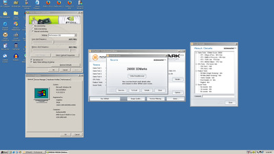

Using the power of a QEMU based VM and GPU pass through! I did it.
29,000 3DMarks.
To be more specific:
A vm consisting of
1 core from a Ryzen 5 5600X @ 4.8GHz
16GB of RAM
And a 7900 GTX clocked at 695MHz core 865MHz memory
For reference, I’m using version 3.2.0 of 3DMark 03

Majority of the score increase comes from Game Test 1 which is heavily CPU based, GT2, GT3, GT4 are all dependant on the GPU Core/Mem values and don't differ dramatically from my scores. From what I remember my 7900 GTX can't really overclock well, so I am already at the lost position 😒
Are you using single GPU passthrough under Linux host? Or two GPUs? Or something else?
3DMark03 Version 3.5.0 is the latest one for 98SE.
We can't really get much more performance from the GPU side of things, it's now all about getting the fastest CPU to run under 98SE...though I prefer real hardware results 😀 Should QEMU results count anyways? Maybe they should be put into a different category?
If your UEFI is lucky enough, you might be able to run 98SE natively...though would the performance be the same?
Are you TheMiningTeam?

To answer your questions (I should learn how the list item in the Vogons toolset works):
1: On the host side, I have a GTX 1080 that I use for the host and a 7900 GTX that is passed through to the VM.
2: Ah, okay. I'll grab that ASAP and get back to you with the score. If my 7900 GTX cooperates. It really does not like running at these cloks.
3: I kinda agree with you. Running 98 on real hardware is much harder than running it in a VM, as I can personally attest to.
4: So my BIOS does support CSM. The problem is peripherals. I don't have PS/2 peripherals ATM, and additionally I only have 1 PS/2 port on the board. As far as I can tell, this motherboard only has USB3 controllers, no USB2 or USB1 controllers, meaning no USB support in 98 even with NUSB. That being said, running 98 natively is still an option I'm looking into. I don't love the idea for the reasons above, plus the fact that all the info I've read says that QEMU with KVM acceleration has only a tiny CPU overhead, mean that it likely would be more trouble than it's worth. It's probably technically possible, but I don't want to at this time.
5: yes, how'd you know?
