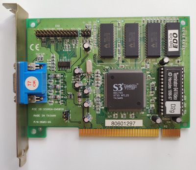

Graphics card #1
The S3 Trio64V+ is highly compatible with DOS games, which is the main reason I chose it for this build. My particular card is a Hercules Terminator 64/Video. It has 2 MB of EDO RAM and provides a razor sharp image. The BIOS supports VBE 1.2 out of the box, but this can be upgraded to VBE 2.0 using the S3VBE utility which slightly improves performance in SVGA resolutions. Lastly, using this Hercules driver CD I can force SVGA DOS games to run at 120 Hz on my CRT monitor which is much easier on the eyes than the default 60 Hz. Under DOS and Win3.11 this is accomplished using the Hercules SETCRT utility. Under Win95, the refresh rate and resolution are managed through the Hercules Touch 95 application from the same CD.

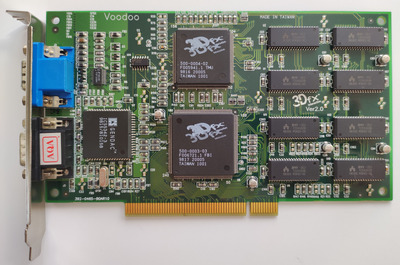

Graphics card #2
The original 3DFX Voodoo Graphics is a legendary card, providing unmatched 3D performance in its heyday. My particular model seems to be made by A-Trend, according to the pictures at VGA Museum. It will mainly be used for DOS Glide games which aren't as compatible with later Voodoo cards. There is some minor image quality degradation in 2D due to the pass-through cable, but it's less perceptible at lower resolutions such as 640x480 and below.

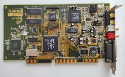

Sound card #2 - Sound Blaster AWE64 Gold CT4390
This card is used for late-era DOS games which benefit from 16-bit sound but don't have native WSS support. Examples include Crusader: No Remorse/No Regret and Privateer 2. While the built-in wavetable is nothing special, it can sound surprisingly nice in certain games that were optimized for AWE cards. The CT4390 resides at A240 I7 D3 H7 P300 E640 which isn't a problem as most of the later DOS games allow you to select these parameters manually in setup. Its MT-32 emulation is also pretty decent for games that don't use custom instruments (e.g. Monkey Island 1).
Most DOS games made in the later half of the 90s support the AWE32 mode directly and the earlier ones can be made to use it through General MIDI emulation, but only if they don't run in protected mode. Under Win95, the emulation is much better, and any game can access the wavetable through General MIDI. The AWE64 Gold has 4MB RAM on-board for loading soundfonts which can make General MIDI music sound even better in DOS games.
It should be noted that even an AWE64 Gold exhibits stuttering in Build engine games when a high sampling rate (like 44.1 kHz) is used for digitized audio while an external MIDI device connected to it is playing. I avoid this bug by delegating all MPU-401 duties to the Yamaha card.

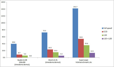

And here are some benchmarks. Basically, I get Pentium at full speed, a 486DX2-66 at the next speed level (CCD), a 486DX-33 after that (L1D) and lastly a 386DX-25 (L1D+L2D). I could probably fine tune this even further by applying slower memory timings in the BIOS, downclocking the CPU to 133 MHz and using some of the other test registers. But truthfully, the current slowdown range covers my needs quite nicely. Big thanks to Gerwin for developing the excellent SetMul utility which makes all of this possible!

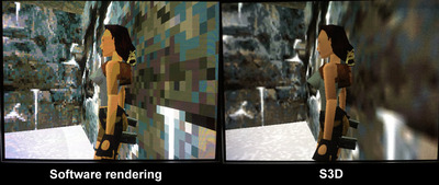

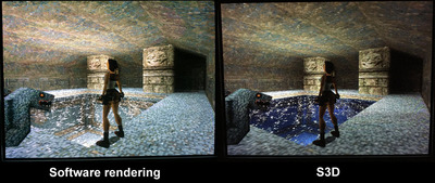

Here are some software rendering vs. S3D comparisons for Tomb Raider. I had to take the photos using my phone as the game doesn't provide any way to create screenshots.
121.01 KiB
8854 views
With software rendering, you can notice color banding on the snow as the shadow fades into the light. In S3D mode, that transition is completely smooth.

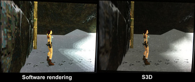

162.93 KiB
8853 views
Again, some color banding can be observed on Lara's arm and face in sofware rendering. In S3D mode the shadows are smooth and the wall textures look nicer as well.
214.66 KiB
8853 views
Water is completely transparent in software rendering. In S3D mode it has a blue tinge and some additional lighting effects.
As noted before, S3D mode delivers around 15 FPS at 640x480 with an overclocked VirgeDX. On this system, software rendering runs slower than that when using the same resolution. Notably, S3D also brings 16-bit colors, perspective correction and bilinear filtering to the table while reaching a slightly higher frame rate. In conclusion, the Virge is worth using on a slow system such as this, unless you happen to have a Voodoo card.

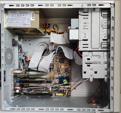

Reply 9 of 73, by Joseph_Joestar
Unexpectedly, I stumbled upon a Soyo SY-5BT motherboard on my local classifieds. It's based on the Intel 430TX chipset and has an ATX power connector.
I think I will rebuild the system using this motherboard and keep the M571 for future use in a K6-2 build. Updates to follow.
Reply 10 of 73, by Joseph_Joestar
And it's done! The Soyo 5BT motherboard is in place and an LC Power PSU is now used instead of AOpen, mainly because it's much quieter. I have also added two sound cards to replicate the SB16 and WSS functionality of the previous build. Interestingly, the Pentium MMX 166 runs slightly better on the Soyo motherboard. Performance is about 5-10% higher compared to the M571 in every test except Doom, which is somehow a bit slower.
Note: originally, I had built this system around a PC Chips M571 motherboard and its integrated CMI8330 sound card, but have since decided to re-purpose that for a K6-2 rig. Reviews of the M571 and the CMI8330 can be found below.
Motherboard
Although PC Chips motherboards generally have a bad reputation (some deservedly so) the M571 seems to be the exception. It's astoundingly well documented with sites like this and this containing PDF user manuals with jumper settings, complete pinouts for all the on-board connectors (including PS2, USB and audio), multiple BIOS versions (official and modded) and even several revisions of the driver CD.
This particular motherboard was saved from the scrap pile and gifted to me. Finding a Socket 7 board locally is becoming increasingly difficult, so I was very happy to get this. Unfortunately, it came bare, without any brackets for on-board audio, PS2 mouse, VGA, USB and so on. However, the pinouts for all of the motherboard connectors can be found online. Encouraged by that, I bought a generic PS2 mouse bracket as well as a nondescript audio bracket and then rewired both to fit the relevant connectors. This worked surprisingly well. I didn't bother doing the same for the USB bracket since this system uses CF cards for storage and that makes it easy for me to transfer files.
The VGA, serial and gameport connectors all use standard pinouts, so I just bought some generic brackets for those and everything worked fine. After some testing, I noticed that the DOS game compatibility of the on-board graphics chip wasn't so good. It also didn't seem to have any 3D acceleration capabilities. In light of those findings, I opted to use a dedicated graphics card.

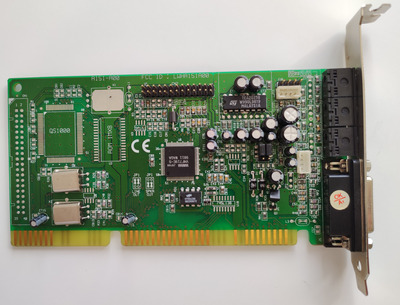

SoundPro 1869V+ (integrated CMI8330)
The CMI8330 is an interesting chip. According to the datasheet, it features SBPro, SB16 and WSS compatibility, which is quite rare. At the same time, it doesn't suffer from any of the bugs that plague Creative's cards. Its SB16 mode properly supports High DMA so all the Build engine games work fine. I was also pleasantly surprised with how little self-noise this card has. I wonder if that's because it's integrated into the motherboard, or if it's an inherent trait of the CMI8330 chip.
Gerwin posted an excellent review of the standalone CMI8330 card, and from what I can tell, my integrated version behaves the same way, except that it doesn't have SPDIF Out. I'm unsure if its FM synth is provided by a genuine OPL3 core inside the main chip or a 1:1 copy, but it sounds fantastic in any case. Have a listen:
This card also has proper SBPro stereo compatibility, which matters for games like Aladdin. Under Windows 9x the CMI8330 also has some form of HRTF. It claims to emulate A3D 1.0 and this does seem to work correctly in Thief Gold at least.
However, there are also a few drawbacks. First, any joysticks connected to the gameport of the CMI8330 don't function. Gerwin noticed the same issue in his review and it appears to be caused by a faulty resistor. Surprisingly, external MIDI devices do work correctly when hooked up to the gameport. Additionally, the chip does not support ADPCM, so any games which use that (e.g. Duke Nukem 2 and Major Stryker) won't sound correctly. Another issue is that IRQ and DMA resources cannot be shared between the SB16 and WSS portions of the card, which makes it quite a resource hog.
I noticed some game incompatibilities as well. Stonekeep refuses to start despite correctly detecting the sound card in setup and passing all the tests there. Mortal Kombat 1 and Jagged Alliance both freeze on start. A few games such as Space Quest V and Red Alert don't work in WSS mode when it is configured to use DMA 0 (which is the default for this card). In some cases it's possible to avoid this issue by setting SB16 to DMA 3 and WSS to DMA 1.

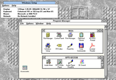

Reply 13 of 73, by Joseph_Joestar
Noticed that there's an updated Windows 3.11 VirgeDX driver here on Vogons. This one works perfectly, allowing 800x600 with 24-bit colors. Not sure if there are any Win 3.11 programs that can actually use that color depth, but it's nice that it's available. Obligatory screenshot:
128.37 KiB
8466 views
The OPTi 82C930 also has fully Win 3.11 compatible drivers. The installer automatically set up MIDI Mapper for both FM synth and MPU-401 so everything works flawlessly.

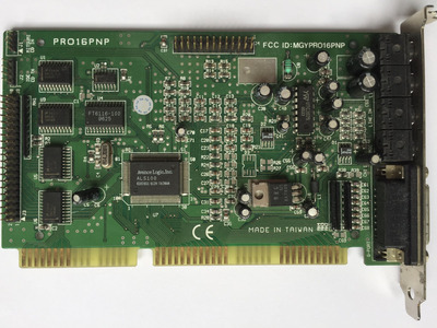

Reply 17 of 73, by Joseph_Joestar
Oetker wrote on 2021-06-16, 04:58:
In my machine all three cards I've tried either aren't detected or hang when playing sounds. Or work for a few seconds from one channel and then hang.
Strange. I have tried my ALS100 in a couple of different systems (first three in my signature) while doing some tests and it has always worked fine for me.
For reference, I'm using these drivers. My card model is a "PRO16PNP" and it looks like this:
192.22 KiB
8381 views
