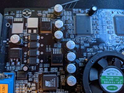

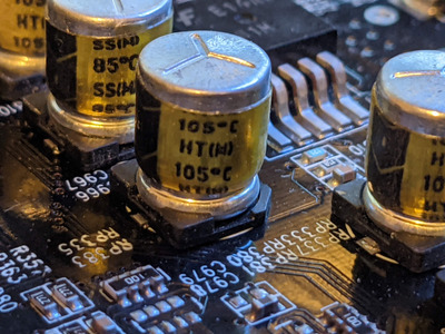

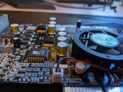

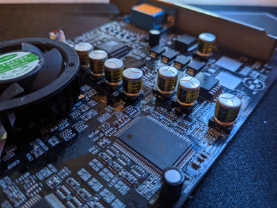

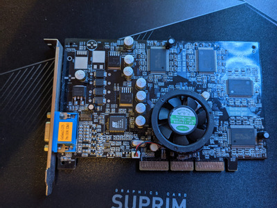

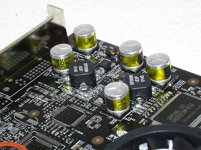

It was mentioned to me on here that the caps on my Geforce2 GTS Pro may be bulging and need changing, I said I would take some close ups and get them uploaded.
I think they are just fat caps but could be wrong, this GPU had been in the loft since about 2002 until recent, looks just how I remember it.

Ah right I see, what kind of Caps would I need to order? Are the the little black things at the base a part of these caps?

Those are SMD electrolytics, and yes the black plastic bit will be included when you order new caps. Look at the labels to determine capacity and voltage, and measure the caps to see what size footprint you need to order (these can all be selected for in Digikey's or Mouser's search forms).
Reply 4 of 33, by pentiumspeed
These little black bases is just that, base so they can sit upright without tipping over during soldering process and ease of manufacturing by consistently bending lead over mechanically.
By the way, they are bloated due to tops not flat and starting to cone. Replace them, and bonus is your board have through holes where each capacitors are, so you go ahead and buy radial electrolytic capacitors based on lead spacing instead of hard to solder SMD capacitors.

They look fine to me. If they were bulging they would be out of the vent perforations at the top. The pressure required to bulge the main body would be more than is required to pop the cap on it's own.

They're definitely bulging, you can tell the way the light is reflecting off the top. Electrolytic capacitors have about a 10-15 year lifespan to be within their rated specifications anyhow, so they should be replaced. Beyond that, the electrolytic formula degrades and/or starts to dry up. They also get oxide layer degradation, which can only be partially fixed by reforming the capacitor out of circuit.

I've seen televisions from the 1950s sit in the California desert for 40 years and come out working. Capacitors aren't as severe a failure as most people consider them to be. These aren't leaking and they don't appear to be bulging any more than they were when they were new.
If they were drying up they wouldn't be bulging.
Reply 10 of 33, by wiretap
That's incorrect, since as they dry out, they get hotter during use and generate more hydrogen gas to begin bulging.
If you pulled electrolytic capacitors out from not being used for 40-50 years, they would certainly need to be reformed at a minimum, but more than likely need to be replaced. They would not perform anywhere near their rated specifications.. and they would fail in short order once heated up in circuit with hours of use.
I am not basing this off of "I saw this one time when.." - I'm basing it off failure analysis and EPRI topical reports since this is an area I work in daily in the nuclear industry with circuit boards mostly from the 70's, 80's and 90's.

I've seen similar capacitor on Hercules 3D Prophet II GTS 64MB. Replaced it with new, but it turned out that old one was perfectly fine, despite slightly dome-shaped top.

These caps are probably fine, here is another shot of a brand new GF2 Ti.

Just looked up the thread where the capacitors were questioned ( Re: Beige-Beast ). Are there any problems when using the card? I think I'd probably take the view that as long as nothing has leaked on to the PCB then if the card is working ok I'd just leave the caps alone. If you get graphical glitches when running video stress tests then consider changing them, and if anything has leaked then definitely take the caps off and clean the board.

I have no issues after much stress testing and gaming, also have the memory over clocked and not a single glitch or crash.
There is no leaking, the reason I asked about fat caps is because on photos from reviewed units from 2001 they look exactly the same to me.
I'm far from a expert so seeked advice here as I wanted more opinions, I was taking the stance don't fix what's not broke as there is no issues in Windows or leaking.
