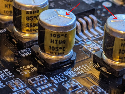

Bulging Caps or just fat caps????

Ydee wrote on 2021-06-07, 10:22:
Is the bottom of the capacitors flat or convex? The new capacitors have a bottom flat.
They all feel flat and look the same shape as in none fatter than others from bulging.

Yes I understand I think I may wait for signs of issues due to GPU before changing these caps.
Reply 24 of 33, by Joakim
This is a sensitive subject for vogons! I would guess it has to do with some members been less lucky in the cap lottery. See these subjects from time to time here.
Being one of the people that said they look bulging I'm no longer sure when comparing to the reference. Seems like a weird thing to do, to design them to look like friggin barrels but who am I to judge? 😀
