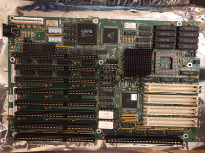

Can't get into CMOS setup on old 486.
Reply 40 of 68, by Keatah
Thanks for the options and suggestions.
Unfortunately the board remains stubborn and recalcitrant. Maybe there's some secret agent stuff in there or some hidden coded message!
The board is cosmetically perfect and would pass for NOS. It's nostalgic, coming from a time when I got into PCs. But perhaps it's time to move on to the next project

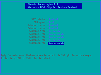

Reply 44 of 68, by Keatah
Sorry about that if I mis-worded anything.
Yes. My ripped BIOS from the original board worked fine in PCEM. I found the next revision BIOS, G22-2 in a pile of files. Plugged it into PCEM. And it worked fine there too. I was able to get into the screens and make changes, in PCEM.
I used 2 different 27C256 EPROMS, burned them, HI and LO, plugged them into the bastardboard and it still failed in the same manner we've been discussing.
Meantime, from PCEM:
40.82 KiB
246 views
28.15 KiB
246 views

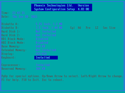

The Turbo Button doesn't seem to have an effect. But by looking at the setup screens, the system likely needs to be set to "SLOW" and then the Turbo Button would toggle it between SLOW/FAST. And it likely wouldn't actually change any clock speed. I think (somehow) that it inserts wait states to simulate slower operation. That's a guess. Only did the earlier machines like the ones with the CPU operating at bus speed actually change speeds..? A guess too.

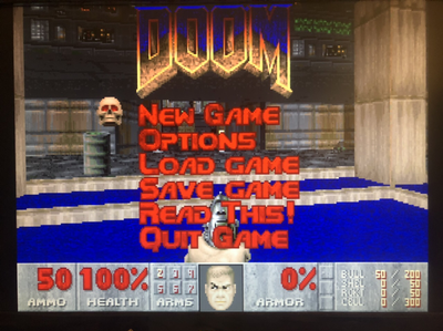

Reply 55 of 68, by Keatah
For Real! Thanks to all! The world now has one more slightly smarter hobbyist, and another functional vintage motherboard.

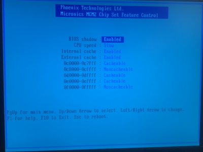

The configuration of the Level-2 cache. The board's jumpers and switches were set for cache size of 256K, but the installed cache was actually 64K. They looked to be the original factory-installed chips, just that somehow the board was mis-configured.
8 chips of 8K x 8 SRAM vs 8 chips of 32K x 8 SRAM.
It was suggested the cache could be at fault. So I pulled the chips and put them in my TL866 'prommer which can test SRAM. After 3 of them showed bad I got to wondering. Got the datasheets for them and a size discrepancy was immediately apparent. These 8 chips were 8K x 8 meant for a 64K cache. I retested them as 8K chips and they were fine. Reconfigured the DIP switches and jumpers and it powered up as usual. But this time it gave me the F1 and F2 options. F2 took me right into the BIOS setup screen.
In effect I suppose the improperly configured cache made the first 64K work incorrectly. This was also mentioned earlier the discussion - BIOS was never able to proceed far enough.
