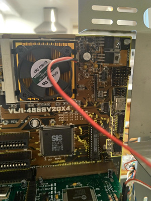

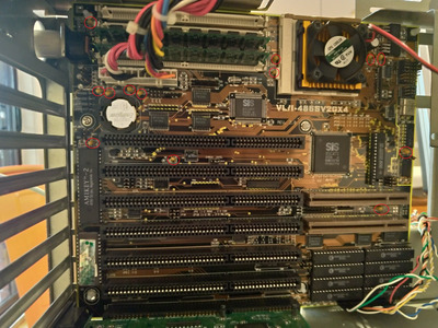

Hi guys, I can't figure out what I'm doing wrong.
I can't seem to get my board to post just get a buzzing sound and the PSU seems to stop supplying power as the fans in the psu and on the cpu don't spin. if I disconnect the PSU from the board it works again.
seems to me it might be a setting somewhere but this is my first build and i'm not sure what it could be.
It's running a am486dx-100
and two sticks of single sided fpm 16mb simm ram
I've removed the battery waiting and reinserted. checked cpu alignment, checked jumpers as best i could. not sure what else to do?

Your PSU refuses to start because there's a short in the board. Very likely at least one of the tantalum caps has failed short.
You will need a multimeter (and possibly desoldering the tantalums) to properly determine what is causing the short.

You can start by checking for continuity between the pins of the power connector: the 4 middle ones are GND, so if there is continuity between those and one or more of the outer pins then you have a short.
Make sure to remove CPU and other cards, do your testing on the bare motherboard without anything connected to it.
