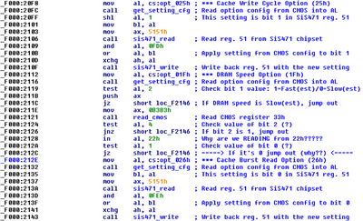

Reply 16 of 26, by TheMobRules
First of all, I'm sorry about resurrecting this thread, but I wanted to thank @jakethompson1, as this has been extremely useful for some BIOS tinkering I've been doing.
Also, I wanted to discuss certain details about what is mentioned in the section "Un-hiding options in SETUP":
jakethompson1 wrote on 2021-07-08, 01:40:
a byte identifying which CMOS register is controlled by the setting
So, currently I'm troubleshooting a 486 BIOS (08/08/1993 core) and I've noticed that it completely ignores a couple of settings related to timings: Cache Burst Read Cycle, which always is set to 2T despite setting 1T in the CMOS setup, and Bus Clock Frequency Select, which also ignores the user setting and is fixed at 7.159... MHz instead of using the Bus clock frequency dividers. I'm using CTCHIP34 to verify that these chipset register values remain unchanged at all times no matter if I change them in the CMOS setup. Other registers for timings and options are set correctly according to the option chosen in setup.
Now, since it's a VLB motherboard having a slightly slower ISA bus speed is not of great concern, but the inability to set 1T on the Cache Burst Read Cycle has an effect so notorious that L2 cache is not detected when setting main memory to the tightest timings, due to the small differences between those speeds.
Returning to the BIOS modding, I've noticed that the CMOS register number where these options are set is not the same as the chipset register number that is affected (for instance, in the BIOS setup the CMOS register for the cache timings is 36h, but the chipset register that handles this in the SiS471 chipset is 51h). So, I assume there has to be a mapping between the CMOS register values that are set on the SETUP utility and the chipset register so the chipset is configured at boot time right? I assume this is where the BIOS issue would be, but I'm not so sure where I could start looking for this. Any help or suggestions are welcome!
By the way, I've noticed that in addition to the first byte being the CMOS register that is controlled by the option (including whether it's hidden or not), the following byte indicates which bits of the register are affected by the setting. Not sure about the 3rd byte, but the 4th indicates the number of options for that setting and after that there is one byte per each option that points to entries in the table mentioned by jakethompson1 that maps all the different options with their labels.

Cache timings configuration code
Broadly speaking, each setting is configured in the chipset by following these steps:
  • First, the position of the setting in the BIOS table described by @jakethompson1 is written to AL
  • A routine I've called get_setting_cfg looks up the CMOS record for this setting and bits affected in the table and reads the actual value from the CMOS
  • When get_setting_cfg returns, it leaves the bits from the CMOS setting value in AL (shifted to the rightmost position)
  • The setting bits in AL are then shifted to the appropriate position as expected in the corresponding SiS471 register they will be written to
  • The current value of the appropriate SiS471 register is read (sis471_read, by first writing the register value to port 22h and then reading 23h)
  • The register value is updated with the configuration bits read from CMOS and written back to the chipset (sis471_write)
For example, in the code above the Cache Write Cycle Option is written by first loading AL with the setting position in the table (25h, Typematic Rate Programming would be 0, Typematic Rate Delay would be 1, etc.). Then, as described above the setting is retrieved from the CMOS and written to bit 1 of SiS471 register 51h.
However, the Cache Burst Read Option is not written immediately after this, instead 3 checks are performed (positions 2112 to 212C in the code). If any of these checks fail, the BIOS jumps to the next settings (DRAM speed and wait states, cache type and all that) without writing the Cache Burst Read Option. I figured this was the reason this setting was not being configured with the value specified in the BIOS SETUP, so let's take a look at what these 3 checks are:
  1. [2112-211C] DRAM speed must be 10 (Fast) or 11 (Fastest)
  2. [211E-2126] Bit 2 of CMOS register 33h must be 0
  3. [2128-212C] Result of reading port 22h bit 0 must be 1
Now, I'm not sure what the last two options mean, but in any case my assumption was that one of those checks was failing, so I wrote a small assembly program that tests those values and bingo! The last one, where port 22h is read and a value of 1 is expected in bit 0 did not pass.
Since the value read from 22h is immediately discarded and not used anywhere else, this check must not affect anything else in the code. So, the patch was easy: I just replaced the JZ instruction that jumps away with a couple of NOPs, since the 1T timing for Cache Burst Read should be easily achievable with 15ns:
