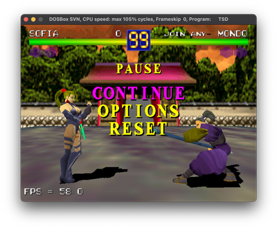

Now, Kekko's Voodoo chip emulation plays in windowed, 640x480 or 800x600 will be fine.
Battle Arena Toshinden 3Dfx Ver 2.5 PC Retail

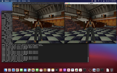

How about the Tale of Two Lara's? 😁
869.3 KiB
1033 views
Tale of Two Lara's
Try the same position and view angle as the in the screenshot on your choice of PC emulators. Maximize the quality with anti-aliasing with 'F3' key. This is a simple performance measurement to max out the field of depth with dense objects scene, a typical stress for any emulators without CPU virtualization. If the PC emulator of one's choice could sustain 30 fps, then it is a high performance emulator, especially if it could be done on mobile CPUs.
The MacBook Air M1 could not only have one but two, both at 30 fps side by side simultaneously. Hey, another performance demonstration, 🤣 not again!

Sadly, the 3rd one is MIA. 🤣 Otherwise, it would show off the so-called true & authentic 3Dfx Voodoo rendering with 16-bit dithering, 2x2 filtering and all the accuracy goodies and "freaking fast". 😉
