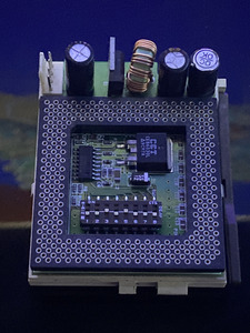

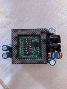

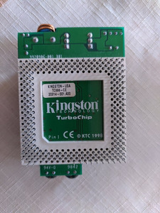

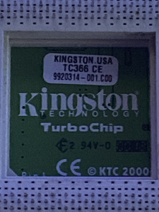

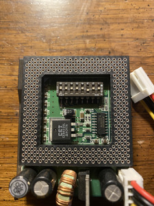

Greetings!
I have a Kingston TurboChip TC366 which used to house an AMD K6-2 366. As far as I can tell, this is a voltage regulator that runs in-between the board and CPU, so as to make sure that the correct voltage is applied. In the case of the K6-2, I believe that CPU required either 2.2v or 2.4V, where as MMX capable boards from that era usually supply 2.8V, maybe 2.7V. Not to mention boards that are incapable of dealing with split voltage and just do 3.3V-3.5V.
In any case, I've had this adapter for many years, but I have never made use of it or even tried it. I got my hands on an Olivetti M24 🤣 a few days ago which I upgraded from an MMX 166 to a 233, however I have a K6-2 450 that I've been thinking of plugging in, in the hopes that I can get it to work at 400, effectively maxing out the CPU for this system (with the possible exception of a K6-III or one of the plus models). The mainboard unfortunately can't do voltages lower than 2.8V, so I've been thinking of using the Kingston TurboChip adapter/regulator to do the hard work there.
Thing is, beneath the socket on the adapter/regulator is a set of 8 DIP switches without a map for the possible combinations. Tried as I might, I could not find any manual or explanation for these switches. Kingston's official manuals do not mention the DIP switches, I don't think they wanted end users removing the CPU from the adapter and only used them internally to configure for different products. The only clue I have is an IC next to the DIP switches which reads:
"f P86AB
RC5036M
A"
Unfortunately, I could not find any datasheets for this. I'm attaching two photos of the TurboChip in the hopes that someone can help me figure out the possible combinations.
Reply 1 of 41, by BitWrangler
I would say there's likely to be three multiplier switches, like on a motherboard, but overriding the motherboard ones, that go to the pins on the top CPU socket, and they are likely to have 10Kilohm resistors on them. Then there's likely to be 5 for setting voltage on that chip you see, which probably have a variety of different resistance values and work like voltage settings on a lot of motherboards. So if original docs are not to be had, you can bleep out the multi pins from a CPU pinout and figure out the voltage settings from the datasheet of the chip and the resistance values.
Reply 2 of 41, by snufkin
I found a datasheet for the RC5036: https://www.datasheets360.com/pdf/635297678915034898
Page 9 has an example/refernce circuit, which Kingston may have followed and could be useful to work out what the switches connect to.

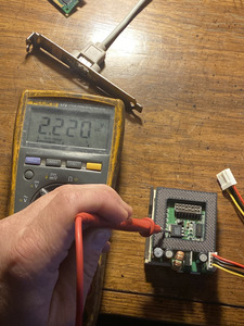

Reply 11 of 41, by Sphere478
Okay 4-8 are voltage switches as suspected
All voltage switches off is 2.020v so this is the base
4 is +0.1
5 is +0.2
6 is +0.4
7 is +0.8
So 2.8v is all voltage switches off except 7
But it gets weird, there appears to be a second tier of voltage settings if you enable switch 8
The second tier has a base of 1.330v
With this new base setting the switch values are cut in half. The +.1v is now a +.05v and so on.
So it seems this adapter can set about whatever voltage you might want!! Awesome!
Ps, not that this would ever happen but be sure power is fully removed when setting these switches, I noted a glitch wherein if full power down wasn’t observed between settings that the regulator would let 5v through instead of the set value.
I can’t imagine a scenario where someone would plug a cpu into a running computer though. But heads up 🤣
Sphere's PCB projects.

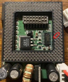

Reply 12 of 41, by Sphere478
Can someone ⭕️ the pins I need to check for those final three switches? Not clear on which ones they are

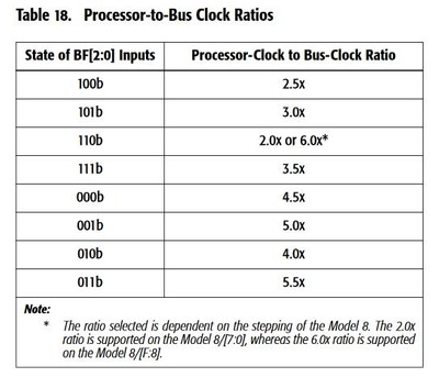

Reply 13 of 41, by snufkin

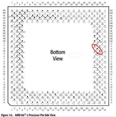

That voltage pattern rings a bell, and it appeared on some motherboards: Super socket 7 motherboard voltage jumpers.
BF pins are here:
105.59 KiB
2013 views
Settings are here:
32.49 KiB
2013 views

Sphere478 wrote on 2021-12-20, 20:16:
Okay, I can see 2.020v on all the vcc2 pins and these two images appear to be in the same orientation
I showed the bottom view of the CPU, forgetting you'd actually want the socket. I think this is right:
91.31 KiB
2006 views
Reply 16 of 41, by Sphere478
Switch 3 is bf
Switch 2 is bf1
Switch 1 is nc (in line with other two pins)
Basically they flip orientation when looking head on a the three switches and pins.
I assume bf is bf0, bf1 is bf1 and nc is bf2
So what settings are required for 2x?
Reply 17 of 41, by snufkin
Sphere478 wrote on 2021-12-20, 20:30:
Switch 3 is bf Switch 2 is bf1 Switch 1 is nc (in line with other two pins) […]
Switch 3 is bf
Switch 2 is bf1
NC? It looks like switch 1-3 go to R6,7&8 (330 ohm). Seems unlikely they would fit all three resistors for one to be NC. Datasheet (I edited post just above yours earlier) says 2x/6x is BF[2..0] = 110b.
[edit: just looked up the datasheet for the 5057 and it gives the 5 bit voltage table there, seems to match what you found, 1.30V to 2.05V in 0.05V steps, then 2V to 3.5V in 0.1V steps. It's actually quite a different design from Garret's]

Reply 19 of 41, by snufkin
Sphere478 wrote on 2021-12-20, 20:39:
Nc is the label for the right most bf pin on the schematic I uploaded. […]
I don’t understand
Edit, ohh! So we want bf 0,1 on and bf2 off?
Ah, missed that, I'd already downloaded a pinout that had them labeled BF2, BF1 and BF0.
Not sure how to describe this, but when giving the setting of a bus of several lines, like BF[2..0], the setting will be in the same order as given in the square brackets.
So BF[2..0]=abc means BF2=a, BF1=b and BF0=c. So BF[2..0]=110b (b for binary, would also make sense to give it in octal/hexdecimal) mean BF2 and BF1 set to '1' and BF0 set to '0'.
