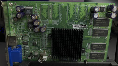

Hey guys,
I got a Gforce 4MX-440-8X Nvidia card. It looos like a new card. I am using Matrox card, but some games are very jaggy with a sprite motion. So i was thinking to have Nvidia beast instead. But my Socket 7 Mobo is not recognizing it. Is it too new for the this board? Or maybe the card is gone? Do you guys have any experience with similar card on similar system?

Cheap card without signal buffers. Also AT motherboards may have problems with 3.3v PCI cards.
Reply 2 of 15, by pentiumspeed
Motherboard's bios issue. This card does have buffers.
Try S3 Virge DX or cirrus logic GD-CL5436 or 30.

I don't have AGP board. My MoBo is Asus TX97-LE (Only PCI and ISA) What will be decent VGA for DOS and Win98? Voodoo3? ATI? I want to play Blade Runner on win98.
AMD K6-II 500, Nvidia TNT2 AGP, 256 MB RAM
•• WANTED: ROLAND SCP-55 ••
Reply 7 of 15, by dionb
dank0 wrote on 2021-07-27, 07:37:
nVidia, 3dfx and S3 generally have best DOS compatibility.
Win98 performance is best on nVidia (or 3dfx depending on title)
If you can find and afford a Voodoo3-3000 PCI it would be an excellent choice, but failing that a TNT(2) or Gf2MX PCI (or Gf4PCI)would be cheaper and at least as fast.
One tip though with nVidia cards on very old systems: don't underestimate driver overhead. Use the oldest driver that gives you the compatibility you need. That's an argument for the TNT(2) as opposed to Gf4MX: the latter is the faster chip, but needs newer, heavier drivers - and that 233MMX won't benefit from the faster GPU anyway.
