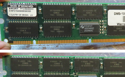

I recently ordered some 128 MB EDO DIMM modules from eBay in hope of maxing out an Intel PR440FX dual Pentium Pro motherboard. The modules are buffered with parity and have 50 ns ICs. The sticker on the modules reads Smart SM572164098E6G5OE0, while the RAM IC's are OKI D51V64405E-50. I was unable to locate a datasheet for either the modules or the IC's.
On the eBay listing, they were noted to be 128 MB modules, but the motherboard reads them as 64 MB. Thus I am trying to determine if the modules are really 64 MB, or if the motherboard has some incompatibility with these modules, e.g. due to memory configuration, refresh, or whatever. Attached below is a photo of one of the modules, front and back. I did notice that the IC's on the back are flipped around, though it seems unlikely that they would be wired incorrectly.
Not sure of it matters for memory compatibility, but I am running two Pentium II Overdrive units at 333 MHz.

I'm fairly sure you've got 128MB on those modules, but I am not very sure on how they are arranged, at first I thought it was too many banks, but there is also a question about if it's seeing "deep" enough into each chip. For example, if they were 64Mbit, 8Mx8bits it would be 8Mbit deep on each row, if they wer 64Mbit 4Mx16bits they would be 4Mbit deep. But what I'm getting from the chip number is that they are 16Mx4bit which means 16Mbit deep, so if board only supports conventional 8Mx8 DRAMs then it's not seeing the upper 8Mbit per row.

PC Hoarder Patrol, thank you. The part numbers aren't identical so all I can do is speculate. The closest part number for buffered, ECC, 168-pin DIMMs is:
16Mx72         Jedec         SM5721640UUEUGU        1.250        EDO/FPM  16Mx4      -     3/5       4K/8K
This supports BitWrangler's initial thoughts of 16Mx4 and it being "too deep", but before concluding this, we'd ideally have some case examples of known working 128 MB modules and lookup their specs.

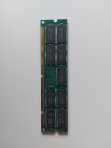

This Samsung 128mb module works in my PR440FX. I also have a Siemens one with similar layout that also works. I have 4x 256mb IBM modules that I bought for this borad but I haven't tested them yet and I have no clue where they are.
The pics were taken with a phone in bad light and also got compressed (even more) by the forum software but it was the best I could do for now.

Skyscraper, thanks for those images. Those appear to have sixteen data 8Mx8 IC's on them. So I guess my reasoning on how the data width is added up is wrong because 16x8bit = 128 bit, not 64-bit.
It seems hard to believe that the Intel website saying that 16Mx4 work would be incorrect, so I am still confused why these OKI-based 16Mx4 modules aren't showing the full 128 MB per module.

8x8s would normally be wired as two sides (DIMM banks) of 64MB
