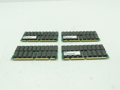

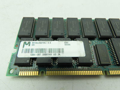

These are the 256 MB modules I just ordered.
230.17 KiB
36 views
163.66 KiB
36 views
I paid $69 with free shipping to AVICC. Seller was asking $100. I should have put in the offer at $45. He accepted my $69 offer within 5 minutes. haha.
But today I saw another listing for the same modules at $60 + $5 shipping to AVICC and it was for 8 pieces instead of 4. To add some salt to the wound, I got an offer from this alternate seller for $45 +5 shipping (to AVICC). Not like I need 8 pieces, but I still overpaid by $19 still.

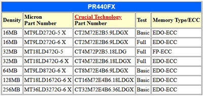

I'd be hopeful 😀 as these look like the 50ns variant of the ones Intel listed as vendor tested by Micron
158.62 KiB
31 views
Reply 27 of 28, by feipoa
Oh nice, could you paste the hyperlink that table came from?
