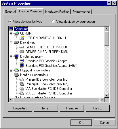

- In the device manager, there is now under Hard disk controllers "Standard Dual PCI IDE Controller" (with a yellow exclamation mark) and "VIA Bus Master PCI IDE Controller" (working). Under the properties of each controller go to Settings and change the Dual IDE Channel Settings so that there is only one IDE Channel enabled for each (for example Primary if IDE0 or SATA2 is used, Secondary for IDE1 or SATA3), then reboot.
- Again in the device manager, update the drivers for "Standard Dual PCI IDE Controller" by choosing "VIA Bus Master PCI IDE Controller" (with Show all hardware), then reboot.
- Now there are two "VIA Bus Master PCI IDE Controller" devices in Device Manager with no yellow exclamation mark. In the properties of the optical drive and "GENERIC IDE DISK TYPE00", tick the DMA checkbox - otherwise performance of the HDD/ODD will be limited to around 3 MB/s. With DMA, performance is up to around 130 MB/s.

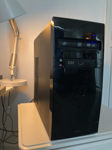

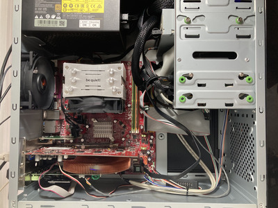

Finally, some pictures: the cooler is a be quiet! Pure Rock Slim which has AM2 compatibility (dropped in version 2 of this cooler) - PWM support must be enabled in the BIOS, and the case the Advance 6016CR Little Box (with the USB card reader replaced by a Gotek):

EDIT 4: I did some more experimenting. I was dissatisfied with your method of installation, because it left me with two devices in system devices that would not install properly and had an exclamation point ('Motherboard Resources', with a resource conflict, and 'PCI Bus', which complained that I could not have two separate devices of the same kind). Everything worked well though, but I found a much easier way to get things installed smoothly, with very little effort, and no system hanging during the installation process. The method involves disabling ACPI (and perhaps it's also worthwhile disabling HPET) in the BIOS. Disable all the integrated peripherals as well such as LAN, serial ports, parallel port, audio, etc... Then boot to dos and run setup with the "setup /p i" (note the space between the 'p' and 'i') parameter. After the first reboot, if you have more than 512mb of ram, it will not allow you to proceed. You boot to a command line and run patchmem and ptchsata. Reboot, and then you proceed with setup, which will complete gracefully without any hanging or errors. Once in Windows, install the Via Hyperion 5.24 drivers. Deselect all but the first option (chipset) from the installation program, and the setup will run and then complain about not being able to proceed because it was interrupted. Click finish and reboot. It will do the detection at startup of all the system devices. For each device where it stops you and asks for help, just select automatic search and it will proceed to find it itself. After everything's complete, reboot, and you're all set. No need to configure IDE or anything like that. The only thing that you need to install now is the USB 2.0 controller if you have that enabled in the BIOS. So just run NUSB36E, reboot, go to device manager and do an automatic search for the unknown device and it will find the VIA USB controller. You can now re-enable devices as required from the BIOS, see what works and what doesn't.
Two things to note:
1) None of the VIA drivers are actually "drivers". Not a single VXD gets installed. This also applies to the USB driver. Rather, they are all INFs that tell Windows how to configure Windows to use the device with the default Microsoft drivers
