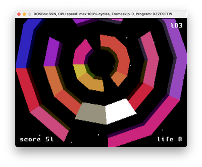

First post, by thp
A game jam game from last weekend turned into a DOS/Windows 95 retro game.
Edit 2021-10-15: Final build Dzzee 1.2 available here

Gameplay
Posting here in the video forum, since it might be fun to try different video modes and acceleration modes and benchmark different systems. Also, the 3Dfx mode was developed/tested using PCem and DOSBox, so if anybody could give it a spin on a real Voodoo Graphics, that'd be great (I don't have a 3Dfx card anymore). Obviously, no warranty that it won't destroy your monitor or graphics card, but so far I've successfully tested the builds in DOSBox, PCem, Windows 95B running in PCem, Windows 98 SE on real hardware with an ATI 3D Rage Pro and a GeForce FX 5200. Feel free to post videos, FPS numbers (with your setup) and photos of the game running.
Dzzee 1.0 -- A well-rounded game that makes you dizzy [DOS/Win95 RETRO BUILDS] […]
Here comes another little retro toy: Dzzee. Control the white rectangle
with the UP and DOWN arrow keys. Stay on the lanes, avoid the gaps. Survive
longest and retain health points for high score.

Reply 2 of 37, by thp
Gmlb256 wrote on 2021-10-02, 22:21:
Nice arcade game! Tested it on a K6-2+/450 computer with write combining enabled and got around 27-29 FPS average in-game on 320x240 32bpp in DOS.
Thanks for testing, glad you like it 😀

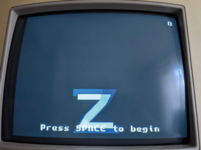

Reply 6 of 37, by Pierre32
Looks cool, but a few issues here. System is a Pentium 200 (non MMX) with an ARK2000 video card and a Voodoo 1, running DOS 6.22.
Running DZZEEDOS.EXE, the only mode that words on my card is mode 1 (13h / VGA 256). Unfortunately this is a little too slow to be playable on my system. Tried UniVBE to no effect.
Running DZZE3DFX.EXE I get the the 3DFX splash, then the game halts here:

Reply 8 of 37, by thp
Weird that the 3Dfx builds work in PCem and DOSBox for me, but that's why it's important to test on real hardware 😀
My first hunch was that it could be related to the Sound Blaster code I'm using (smix). So there's "nosb" builds attached to this post to try. But then I had a look through the code what else could be wrong, and my ISR for the timer didn't properly acknowledge the interrupt (outp(0x20, 0x20);), but this is now added (the "pitfix" builds). The timer interrupt is initialized after grSstOpen() is called, which might explain why it locks up after the 3Dfx logo (and with any luck, Gmlb256 could have just had the splash screen disabled via environment variables, seeing that it was always a black screen there).

Reply 10 of 37, by thp
Ok, here's one last try. This removes the SB code and the interrupt 1C (timer interrupt) handling, so has a fixed time step (10 ms per frame hardcoded), and no FPS counter (as this relies on measuring time). Input handling is done via kbhit() and getch(), so no fancy keyboard interrupt hooking like the dzzeedos.exe. This is now literally just that for initialization:
