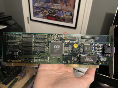

This is the card that was in the Stingray box. Same performance as the 2theMax ARK but much improved image quality at 800x600 and higher, not entirely sure why. Was thinking about adding the missing memory sockets but seems pointless on this card.

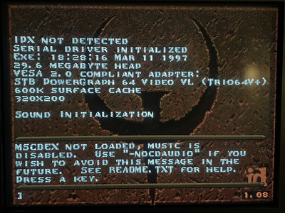

So if I could get Linear Frame Buffer support working on the Trio64V+ it might eek out more frames. I’ve tried an older version of SDD and no vesa modes seem to work, garbage on screen in any VESA mode. I’ve tried the S3VBE tool, and if LFB is on, the screen simply goes blank with a flash of color every now and then. With LFB off I get similar results to SDD 6.53.

LFB makes sense for SVGA modes and has no effect in VGA modes. In SVGA modes a S3 Vision 864 with LFB is even faster than the ARK1000. In all tests without LFB the ARK rules the competition.

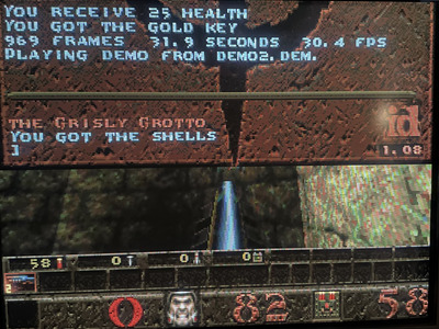

Unleash the S3 fury! LFB FTW!

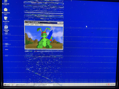

Unfortunately seeing some screen corruption in direct draw games like StarCraft and Red Alert. Always something 🤣. This is without any VESA software of course.

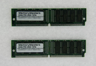

Reply 175 of 266, by Chadti99
pshipkov wrote on 2021-11-11, 09:12:
Spent a moment tonight on this limited ram issue. It is DRAM WRITE WS related. If set it to 1 then 64mb is solid, otherwise if s […]
It is DRAM WRITE WS related. If set it to 1 then 64mb is solid, otherwise if set to 0 only 32mb is possible.
This motherboard does not speak EDO obviously which could be a path to 50ns chips, but it may be possible to find 4x16 or 2x32 FPM modules that do it. My brief attempt was unsuccessful.
Can you provide a picture of your ram module ?
Here’s what I’m using atm. It has chips on both sides. Panasonic 60ns chips.
