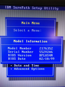

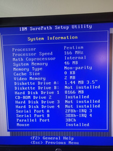

Limpem wrote on 2021-11-20, 12:36:
Well I did some testing and can confirm I have your issue as well on this board. None of the 3x modi seem to work without a bios […]
None of the 3x modi seem to work without a bios error:
150 Mhz (50Mhz)
165 Mhz (55Mhz)
180 Mhz (60Mhz)
200 Mhz (66Mhz)
If you don't mind ignoring the error every boot, the processor will probably work fine at 200 Mhz just as the 233 Mhz works fine on other boards which also cause an error on boot.
You could test it by running cpu-z in Windows and see the reported speed.
I didn't want to do a fresh install to see for myself 😉
If you want to verify if you have the FRU12H2015, it was reported on a sticker above the 2 SIS chips on the mainbord.
Hi, thank you for your help.
You have the same board as I, and you got the same results.
I was able to use the settings for 166MHZ, so I guess I will keep this way, since I do not like having the error every time the machine boots.
I have updated the firmware to early version from dated from 99.

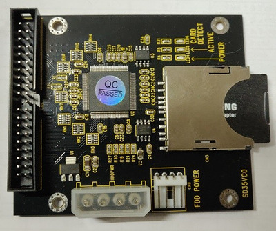

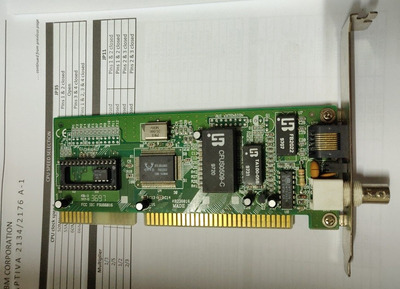

So this is the current status of my build.
Decided to use an SDCard to IDE adapter with 8GB SD to be used as primary unit, and not to use the hard drive. It works great with Windows 98 SE.
Installed this NE2000 ISA network card, and replaced the MWave Audio/Modem with a Sound Blaster 16 card.

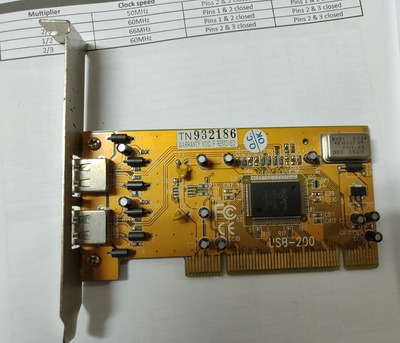

Reply 23 of 58, by soupapes
Also tried this USB2.0 PCI card with two ports, to use with a Zip100 USB drive, but windows 98 becomes very unstable and frequently freezes, so decided to remove it.
I will try later a different branded USB card that I should have in my spare retro junk.

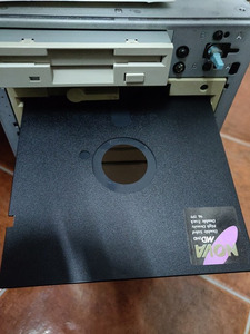

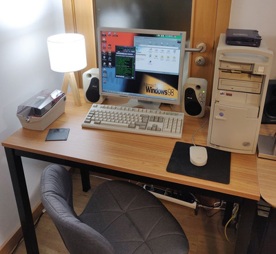

Reply 24 of 58, by soupapes

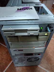

I had a spare 5.25 floppy drive, so I throw it in the case.
I think it looks cool.

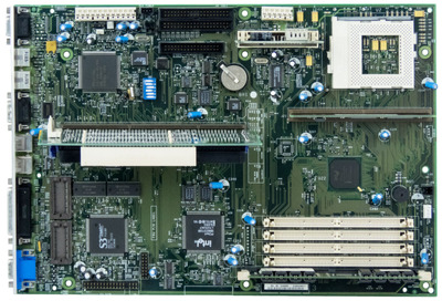

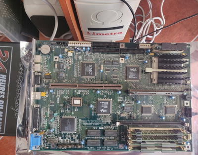

Reply 25 of 58, by Limpem
soupapes wrote on 2021-11-20, 14:02:
Limpem wrote on 2021-11-20, 12:39:
I also did an additional test with a 200 Mhz pentium Overdrive. The bios didn't give any error messages, but also didn't report […]
The bios didn't give any error messages, but also didn't report the clockspeed.
Instead it just said Pentium ODP.
So if you want a 200Mhz error free boot process (and also extra cpu power + MMX instructions) you might consider this cpu if you can find it cheap.
Interesting. I guess I'll try to find a cheap one in ebay 😀
Thank you.
Sweet, but don't overspend!
Overdrive pentiums are usually quite expensive when I see them on ebay.
If you do want to buy them, it might be cheaper to upgrade the motherboard and use a regular pentium mmx cpu.
The boards I can recommend:
1st pick is the 93H4690 (which is what I currently use).
Although it is meant for a totally different system (IBM PC 330) it works perfectly in the aptiva (I did have to unscrew one of the mounts for a serial port for installation).
The advantages over your current board:
-intel 430HX chipset (still 64MB limit though)
-S3 trio 64V+ onboard graphics, which have one of the best dos compatibility
-Works fine with the 233MMX (shows as 100Mhz in bios, but no boot errors)
-Normally functioning pci ports, the Aptiva boards have some limitations with certain pci devices (TNT2, savage4, voodoo 5500 and other cards don't properly work on aptiva including the second pick, but they work fine on this board)
-Option to upgrade the riser board to a 60H9503 which gives 5x PCI and 3x ISA
The disadvantages to the second pick:
-No SD-Ram support
-No overclocking
-233Mhz cpu reported incorrectly in bios, but fully functional
-I never tried any official Aptiva install media, but it probably won't work on this board
-(very specific for my case) the ps2 mouse from my kvm switch isn't recognised by this board

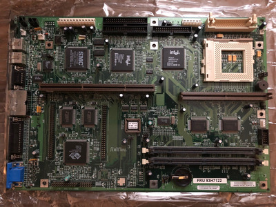

2nd pick is the 93H77122
-Intel 430VX chipset
-Is an Aptiva mainboard and uses the same chipset as the 2176 A2 board, therefore my Aptiva install media worked with this board installed
-Ati 3D Rage II+ onboard graphics
-Works with SD-Ram instead of EDO Ram and EDO DIMM which grants a minor speed improvement with my testing
-Fully supports 233MMX Pentiums with correct clockspeeds in BIOS
-Overclocking to 75Mhz Bus (couldn't get it stable with certain hardware unfortunately)

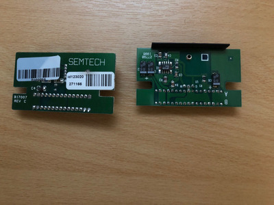

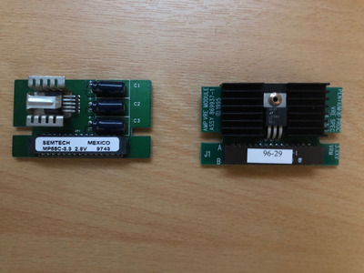

Both those boards will require a voltage regulator which isn't needed for your current board.
In the pictures I included are both the Pentium and Pentium MMX boards.
The one on the left is for the Pentium MMX cpu's and the one on the right is for regular Pentiums.
Make sure the one suitable for your specific cpu is included if you order a motherboard as an upgrade (or order one seperately).
PS, I love the larger floppy drive! Other hardware seems nice as well 😁

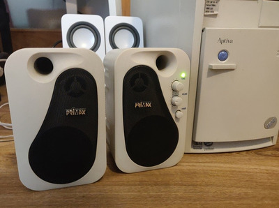

Received today this Primax speakers I found for sale online.
They should be period correct for this build.

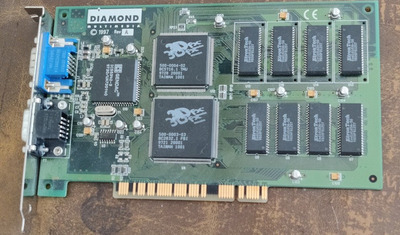

24 years later, finally I have a 3dfx Voodoo card 😀

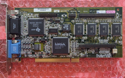

New addition to pair with the voodoo: the Matrox Millenium 4mb.

I was trying to test the 5.25 floppy drive by reading and formatting a new 1.2mb HD disk.
The unit B is recognized in Windows 98 but whenever I try to access the disk I always get an error. The disk is not recognized despite the green light turns on in the floppy drive when trying to read a disk.
The drive is Mitsumi brand and I have found the following jumper diagram online, but I am not sure if I am using the correct settings. That last jumper was missing, so I set the blue one in HS.
Anyone can confirm if the current settings make sense?

Reply 36 of 58, by BitWrangler
Do you hear the motor when the green light is on? If yes, try the LD/HD output jumper on HD.... if not, try different motor select setting first.
Reply 37 of 58, by soupapes
BitWrangler wrote on 2021-12-21, 22:55:
The motor does spin. Tried different settings, but no luck. I suppose is defective.

Bought this from eBay from US to keep it as a spare. It's the later board version.
Haven't tested it yet, but if it works I might use it to upgrade, to be able to use my P200 CPU and also benefit from the USB port.
    335.28 KiB
