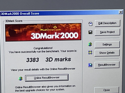

Radeon 9800 pro with 9700 pro cat 3.1 drivers
K6-3+ 570 (modded from 2+)
Freeway ultra
How can I improve my score?
    1.03 MiB
    662 views
Sphere's PCB projects.
Reply 164 of 177, by supercordo
Sphere478 wrote on 2024-01-21, 17:01:
Radeon 9800 pro with 9700 pro cat 3.1 drivers K6-3+ 570 (modded from 2+) Freeway ultra […]
Freeway ultra
No idea with that fuzzy picture.

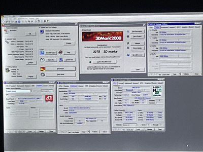

Reply 165 of 177, by Sphere478
supercordo wrote on 2024-01-21, 17:35:
Freeway ultra
Sorry vogons takes forever to upload images from my phone and often errors out so I try to make them zoomed in as possible to get them to upload easier
I recalled previous experience with these via chipsets how much of a difference single sided and double sided made from a speed and stability perspective.
I did manage to find a set of 256mb x 3 sticks that gave 768mb stable that I was running for a few weeks now. But just decided to try 1 x 128mb single sided and 2 x 128mb single sided as a test.
So far 256mb 2x128 single sided has been the fastest. About to try 384mb

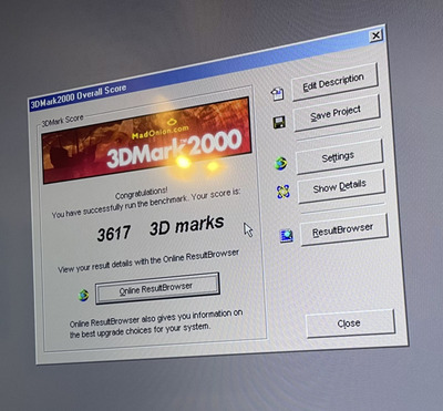

Reply 167 of 177, by Sphere478
Thanks 😀
I’m making progress!
This config is overclocked from previous 112mhz fsb 5.5x core 384mb of ram. 3x single sided pc150 pc150 pc133
I’m trying to recall if I made a cheat sheet for dip settings earlier in thread. Is there a 105 fsb option?
    1.27 MiB
    612 views
