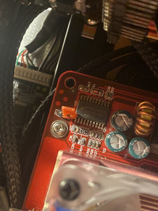

Oh one more thing, does anyone have an idea what this jumper does?
    1.49 MiB
    1343 views
See picture.
See picture.
I see references to jp3 but they aren’t dipected in the pictures. I can’t read Japanese.

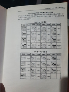

Reply 109 of 177, by dormcat
Sphere478 wrote on 2022-02-27, 21:05:
"Chapter 4: Hardware Settings"
"Table of CPU Vcore settings with JP3 and SW2"
"CPU Vcore is set by combinations of JP3 and SW2. With JP3 shorted, the voltage can be set between 1.30V to 2.05V; with JP3 opened, the voltage can be set between 2.1V to 3.5V."
Upper half: "JP3 ショートの場合" = "JP3 shorted"
Lower half: "JP3 オーペンの場合" = "JP3 opened"
Reply 110 of 177, by Sphere478
dormcat wrote on 2022-02-27, 21:23:
"Chapter 4: Hardware Settings" […]
You rock! Thanks! That makes sense now.
This is really cool. The non ultra doesn’t have this.

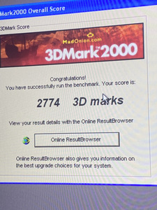

Reply 112 of 177, by Sphere478
Can you walk through what settings you are using in bios and on mobo to get that?
Have you replaced your caps?
I’ve never been able to get the clock setting in the bios to work for me
So is this card/driver combo working only for 3dm2000 or does it actually show gains in games also?
Sphere's PCB projects.
Reply 113 of 177, by Repo Man11
Sphere478 wrote on 2022-04-11, 17:08:
Can you walk through what settings you are using in bios and on mobo to get that? […]
I'd imagine that would depend on the game. When benchmarking with my GeForce 3 Ti 200 I'll get my highest score in 3D 2000 with the 7.76 driver, but the score in 3D 2001 tanks. Using a later driver increases the performance of 2001, but the 2000 score drops dramatically.
I don't want to rob you of your own experience of tinkering by just giving you the settings i used. Thats the fun part.
None of the settings I’ve tried I don’t think have ever given me more than 112

PC Hoarder Patrol wrote on 2021-11-20, 00:59:
Did you notice the manual for your board layout is listed here - https://www.elhvb.com/mobokive/Archive/Tmc%20 … al/ti5vgf10.pdf
