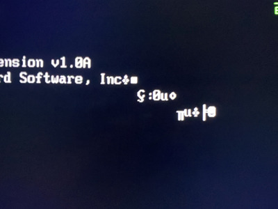

The keyboard appears to be doing this:
1.14 MiB
2125 views
It’s going through a usb hub. This is the first time having this issue on this keyboard with any motherboard, idk why this motherboard doesn’t like it.
So this issue is still not fixed.

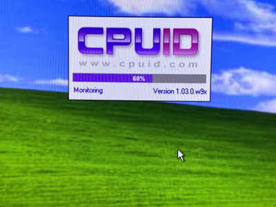

Cpu-z is still hanging:
1.65 MiB
2125 views
Not sure what’s up with that. As you san see it hangs on “monitoring” the whole system fully locks up.

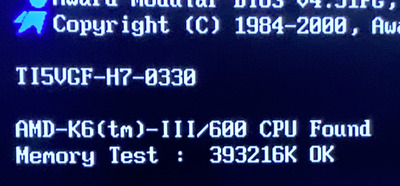

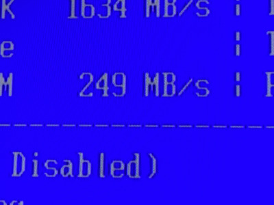

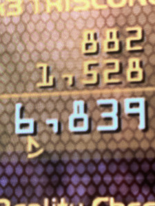

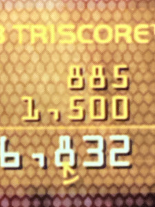

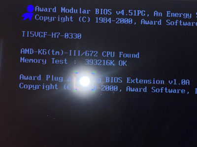

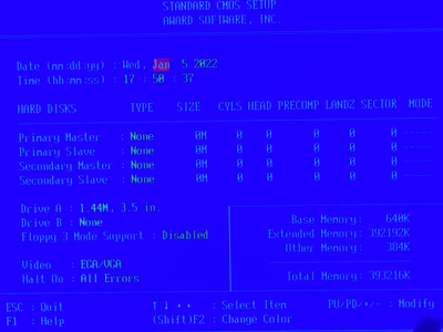

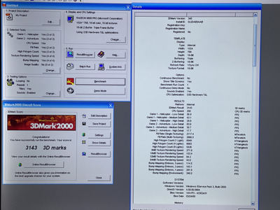

Reply 21 of 177, by Sphere478
The bios did fix this however!! :p
670.61 KiB
2118 views
Not only would it not detect the cpu correctly, it simply refused to post at all at anything above 75fsb, 4.5x multi
This is definitely progress!
Running 3dmark 2000 now, it’s getting fps similar to what I got on my p5a which is impressive.
I need to see what the memory bandwidth is looking like now that I updated the bios.
P5a could get as high as 205 mb/sec (timing tweak/overclock) stable 230 ish unstable in memtest which is the highest I’ve ever seen on a socket 7 build. Earlier when I was doing. Memtest I saw 122mb/sec which is typical for mvp3 that was at 66fsb I believe though. So actually may have been better than my other mvp3 board considering I think my other was doing 120-130 at 100mhz
I usually use my trusty 2cas 256, 256, 128 matched chip sticks for a total of 640 but earlier when troubleshooting I switched to single sided cas 3 sticks for a total of 384. The reason for this is it was actually the most mb that I could get to post in that configuration at 4.5x 75mhz
Now that it’s running at 100x6 I’ll revisit the ram and see what can be done there.

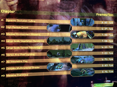

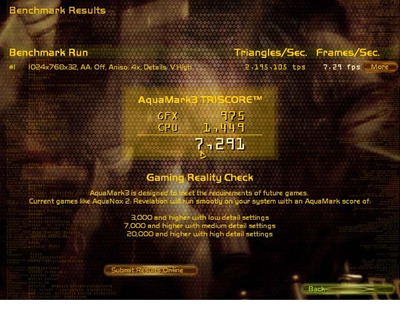

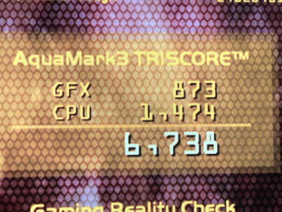

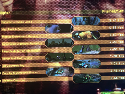

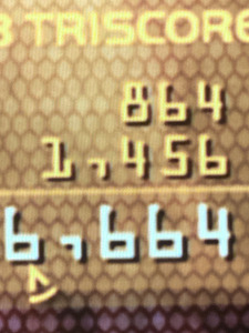

Aquamark
1.5 MiB
2107 views
1.93 MiB
2107 views
I am now going to try and tweak the memory timings.
Happy to report my 640mb of cas 2 now works with the new bios update! (Well, it posts, I mean.. we’ll see how stable!)
1.58 MiB
2103 views

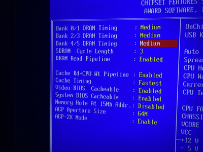

Reply 23 of 177, by Sphere478

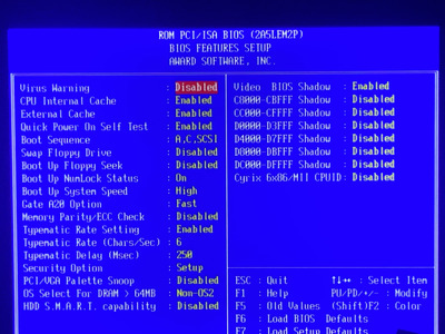

These bios options leave a lot to be desired.. arbitrary turbo, fast, medium, etc settings.
1.03 MiB
2094 views
I noticed a interesting option, not sure if the old bios had it, but it’s cpu/pci clock and has options for setting the fsb/pci at various mhz increments between 100 and 133mhz for the fsb
It gives different options depending on where you have the jumpers set. Here are the options it gives if you set 66mhz fsb

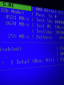

I tried it at 112 mhz? I think it was (100fsb via jumpers) and it wouldn’t post anymore. So I set 66fsb via jumper and it posted, so I went in and set 95fsb in bios and it reset the cmos 🤣 oh well…
Woah, this is the highest I’ve ever seen memtest report on a socket 7!!!😳
Test is only at 5% so will have to see if it is stable.
698.66 KiB
2094 views
Oh holy hanna, this might be stable….😳
997.65 KiB
2088 views

Reply 24 of 177, by Repo Man11
Sphere478 wrote on 2022-01-04, 09:15:
The keyboard appears to be doing this:image.jpg […]
Cpu-z is still hanging:image.jpg
On my Epox MVP3G-M I found that CPU-Z locks up if ACPI is enabled in the BIOS, but works fine if it is disabled.
Reply 25 of 177, by Sphere478

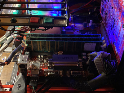

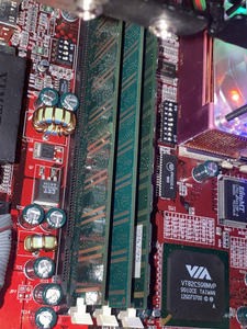

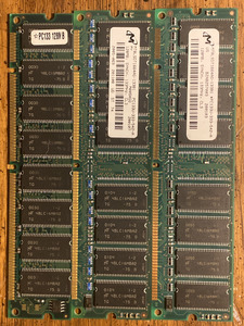

I started having stability issues which memtest didn’t seem to want to clue me in on.
I think I solved it by going back to single sided modules.
1.79 MiB
2043 views
This may explain why I had so many problems with my fic 503+
Anyway, I recall others saying this about theirs as well but didn’t think much of it because memtest was all cool
Now I gotta start from scratch again with bios and mem timing tweaks after debugging all this.

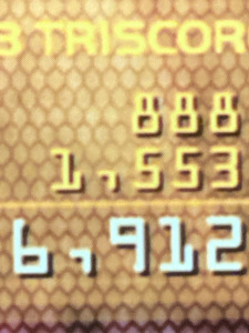

Latest aquamark: (proof of stability! W00t)
1.68 MiB
2042 views
I suppose this raises the question: would single sided 512mb sticks work?
New build Record:
1.85 MiB
2029 views
I think that I can get it higher though
Here we go:
1.84 MiB
2026 views
1.05 MiB
2026 views

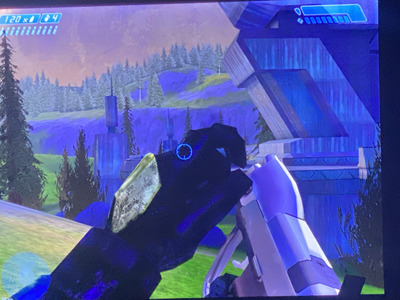

I’ve settled on a configuration that seems to be quite stable here, and since sometimes that’s hard to find, I’m going to follow up with all the parts and settings

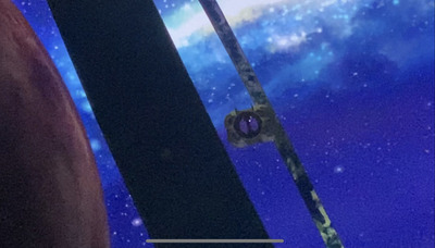

For now: halo ( 1024x1280 at max detail settings 🤣)
232.07 KiB
2015 views
I just played through the first level. There isn’t much fps difference between minimum settings and max settings, I think because of the 9800 pro doing the heavy lifting on the max settings difference.
Without trying to go over 100fsb or 600 core the best scores I can get are the ones already posted for 3dm200, aquamark.
It seems that the memory timings can get far more agressive if you use single sided ram let alone that the double sided isn’t stable at all, i couldn’t get double sided to pass memtest on anything faster than medium setting.
The single sided ram will do turbo on all banks despite some of the sticks being cl3
1.27 MiB
2009 views
It’s not lag free, but it’s playable in campaign. I can even get regular headshots
You are seeing the second level, which I’ve actually played to in one run without crash.

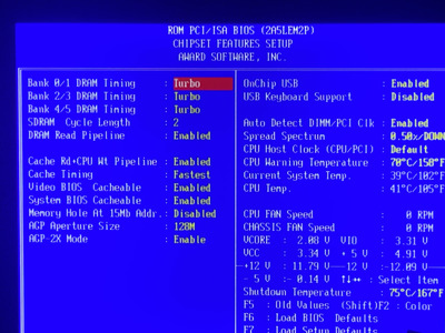

Reply 27 of 177, by Sphere478

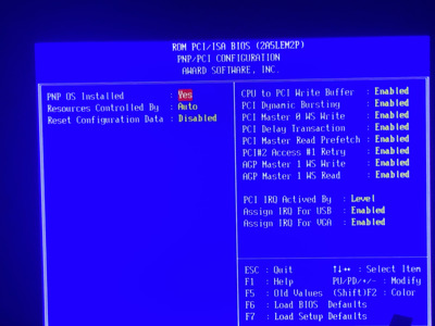

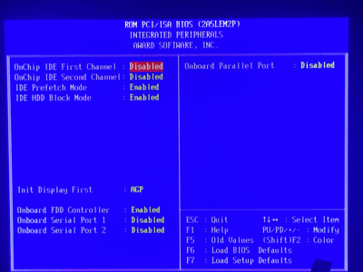

Here are the bios settings of this stable configuration
    563.36 KiB
    2004 views
    801.96 KiB
    2004 views
    740.59 KiB
    2004 views
    809.95 KiB
    2004 views
    428.01 KiB
    2004 views
Sphere's PCB projects.

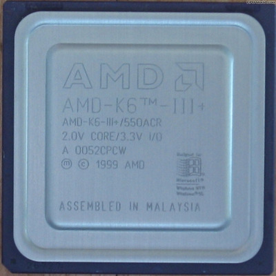

Reply 28 of 177, by Sphere478
Continued:
471.8 KiB
1995 views
Software:
Direct x 9d
All Microsoft sp3 drivers
Win xp pro sp3
Halo ce (origional cd)
Sound not installed
Hardware:
Sound not installed
3x 128mb single sided sticks
1.61 MiB
1991 views
K6-III+ 550acr
83.7 KiB
1991 views

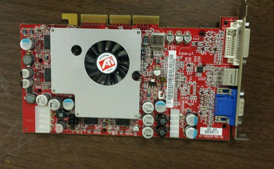

Radeon 9800 pro
289.24 KiB
1991 views
Freeway FW-TI5VGF 1.0 (non ultra)
102.23 KiB
1991 views
Remarks:
-A better graphics card would likely be a gf3 ti 500
-It could be expected that basically any k63+ model could likely achieve this result you shouldn’t need a 550. A 400 would probably do the same thing.
-The Freeway Design FW-TI5VGF is based on the TMC TI5VGF which may be a good alternate for those wanting to replicate this build but it is missing hardware features that the freeway board has I believe, though don’t know all the details.

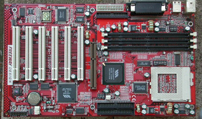

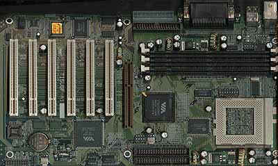

Reply 29 of 177, by Sphere478
The tmc counterpart:
167.4 KiB

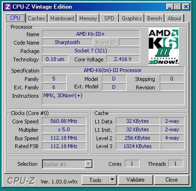

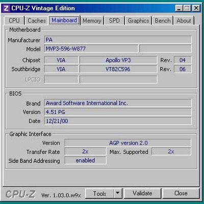

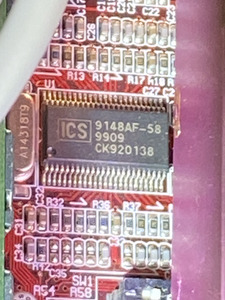

I had some time to investigate the possibility of undocumented fsb settings
Ths clock gen is a ICS 9148af-58
896.96 KiB
1872 views
I wasn’t able to find a data sheet for it
So I tried all (literally all) the combinations and came up with this using a low multiplier on the cpu, external cache disabled and loose memory timings.
1.16 MiB
1872 views
I believe the 225 setting is 112mhz fsb a undocumented setting!
I have now set the multiplier to 5.5x and fsb to 112mhz giving me 616 mhz cpu
But it appears that the motherboard cache doesn’t like running this fast even at fast timing (as apposed to fastest)
Trying 3.4v I/O
No go
Trying 3.5v I/O
No go
Trying 3.6v I/O
No go, went to a black screen instead of usual hang though.
It seems that 112mhz is the only undocumented setting and you have to give up cache in order to use it.
The tests will continue without cache!
Gave 6x multi a try, that’s a no go. It posts to something about boot block.
Not surprising as that’s probably 670mhz. Bummer that it didn’t work, we can all dream though. Maybe I can try it at higher voltage though. This is at 2/2.1v now.
Omg…. 2.4v
1.49 MiB
1865 views
I actually got it into memtest at that speed but not for long and rebooting it didn’t want to post again. Back to 5.5x 2.2v and let’s see what we get.
No cache, normal ram timings, 616mhz core clock and aquamark is doing a run!
So far this speed seems stable. The only question is wether or not it’s faster given that I had to give up 2mb of 4ns cache to get here…
616 core 112fsb seems stable because I made it through aquamark with loose memory timings.
Aquamark score dropped of course, 6,500
Now to tighten memory timings and see if we can get a score increase!
Okay, so I tightened timings to turbo for all three, and 2 and did another aquamark.
940.7 KiB
1849 views
It’s really missing that cache.
All that for nothing..
Back to 100x6 🤣 and cache!!!

Reply 33 of 177, by Repo Man11
I tried my 9800 SE in my MVP3G-M.
Reply 34 of 177, by Repo Man11
That's a bummer that you have to disable the motherboard's cache to hit 112. How's your five volt rail? Edit: I just scrolled up and saw that it's 4.91, which is good enough, so that's not an issue.
Reply 36 of 177, by Sphere478
PC Hoarder Patrol wrote on 2022-01-15, 00:26:
I see a 9148-58 but not a 9148af-58
Repo Man11 wrote on 2022-01-14, 23:03:
You shouldn’t have to do 2.4v to hit 560mhz what’s up with that?
I’m guessing windows 98se is the reason you are getting a higher score?
