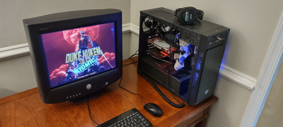

Reply 46 of 106, by VDNKh
Small update.
Spoiler
1.1 MiB
1761 views
I got a great CRT! A Dell P992. It can push 1600x1200 at 85 Hz and 1024x768 at 120 Hz. Been loving it. Got it off Craigslist locally for half of what it's probably worth. The picture is still great and there's not even a scratch on the outer shell. The previous owner was the original buyer and said, in his 20 or so years of owning it, he never opened it or cleaned it in anyway. Is there any kind of preventative maintenance I should do?
Not pictured: I also got a Periboard-107, so now I have a numpad. I can't believe they still make PS/2 keyboards.
The fix for my AGP memory issue still eludes me. I have made more sense of the registers.
AGP Target Registers
file.php?id=134406&mode=view
From my previous post. The register in red at the bottom (PCI Bridge) are not the associated with the GART. The registers in row 10 on top (Host Bridge) are the GART virtual addresses that Windows sees. 08 00 00 F0, which is F0000008 read as a dword. The last 8 at the end denotes that it's a 128 MB aperture. This is seen in Windows as the memory allocation F0000000-F9FFFFFF.
The 00 F0 FB 00 (dword: 00FBF000) is the GART physical remapped address. Depending on what driver I use this can change. I was using an older driver when I made this comparison, that's why it's very different. The most recent AGP driver produces a remapped address similar to Joseph_Joestar's. Still doesn't work though.
I've taken a second look at XP's AGP configuration. The memory allocations are similar but some differences stand out:
  • The AGP controller takes the GART memory allocation in Windows (F0000000) instead of the Host Bridge. I'll chalk this up to XP's PCI driver or memory manager doing things a little differently, plus Joseph_Joestar's comparison proves either way works, but....
  • pci.sys takes an active roll in the AGP driver. Just from looking at device manager I can see that viaagp1.sys and pci.sys interface with AGP, so there's more going on here at the OS level I can't see. This probably due to Microsoft's UAGP 3.5 standard, which this motherboard was built for. I should test with a version of XP that pre-dates UAGP 3.5.
  • The Microsoft PCI driver's memory allocation includes the GART address in its range. I don't have a screenshot or copypasta handy, but it was some crazy range like 000F0000-F9FFFFFF
  • The mystery Motherboard Resource that consumes E0000000-EFFFFFFF is still there in XP. I think it might be the V-Link, But I'm not sure. All XP says is it's on the PCI bus somewhere. Still, it doesn't seem to be a problem there but I'm still suspect.
At this point I need to calmly: sit down, brew a pot of coffee, and learn how to use a kernal debugger for a 23 year old operating system. Any recommendations on the best kind of setup for this problem? Can I run 98 or NT from a virtual machine on my laptop and connect it with a USB to DB-9 adapter? Or do I really need a second machine that supports 98 or NT? SoftICE, as I understand, does not require a second computer. But it seems kind of limited when it comes to debugging drivers at boot.
Edit: Tried the original XP, with no service packs and before UAGP 3.5 was implemented, and it still performs normally. Resource allocations are the same. I downloaded the 98/ME DDK and will play around with it at somepoint.
