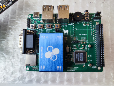

Well, I finally got time to test my Tinyllama and I am stuck at CS4237B eeprom programming. If I enter: […]
resource /f=0x120 /r=cs4237b.asm /e
I get CONTROL not found at 0x120 address
Tried also with the default address, same error.
Any clues?
Is this the 1.1 version of the TinyLlama? In that case, I’d double check your soldering. That command works if everything’s soldered correctly.

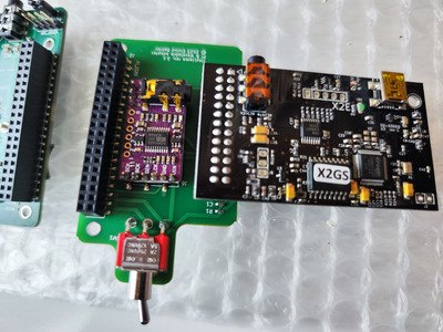

It is the latest one, you sent it to me assembled already. I just desoldered the DAC to put the adapter on top for the wavetable. Perhaps I did something wrong?

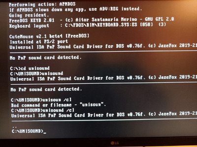

Unfortunately, UNISOUND does not find any PnP card, if I use /CL does not list any card either. Anyway, I should be able to flash again the eeprom despite it have been flashed before I suppose. I tried without the adapter+wavetable, same results.
That is very weird, I've tested unisound and games with adlib, fm synth, digital audio samples and midi on every card I've sent out.

I desoldered the DAC, but I soldered another one I had from the v1 kit just because it was new and easier to put in place (no tin to remove). I suppose the DAC of the v1 is the same of the v2. I tested the desoldered points and the soldered ones, I can't find any damage there. I will examine the board closely just to make sure no small tin fragment is the origin of the problem, but I find it strange really.
Can you take a screenshot of running the unisound command? Also, I assume you've set the BLASTER environment variable first?

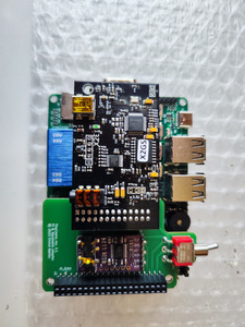

Ok, received the programmer and reflashed the BIOS with the v2, the right one. Now crystal chip is properly detected and wavetable module works like a charm. Finally some fun for the weekend!
