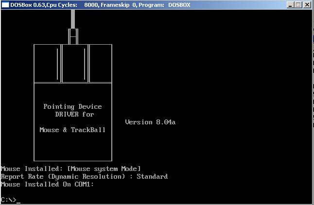

I've some problems with mousesupport in "Der Patrizier"/"The patrician".
Short: mouse doesn't work.
Long: last year it worked fine. However I had to use an extra mousedriver "CTMouse". Now CTMouse gives a short "Error: Mouse not found". I don't know which version of dosbox worked. In addition I don't know if it's a problem related to dosbox, kernel, or ....
Dosbox 0.63
CPU: AMD Athlon 64 3000+
OS: Debian Linux
Mouse: USB
Any ideas?

Reply 5 of 19, by robertmo
OK, it works.
You just have to set
directserial=true
in dosbox.conf
This way mouse drivers work as they did before directserial was implemented.
So I have mouse in The Patrician (german title: Der Patrizer) 😀
(oh, and you don't need to have a real serial mouse 😉 )

Reply 8 of 19, by robertmo
ctmouse.exe driver won't work
I have used my old mouse.com driver
And you have to press Ctrl-F10 after the game starts.
Qbix: It doesn't break a game. It breaks support for mouse drivers.

Reply 10 of 19, by Qbix
Rank DOSBox Author
DOSBox Author
i see.
well the update of direct serial support removed the default 2 comports of dosbox.
Thinking of restoring them if directserial is false.
why does the patrician need a mousedriver anyway ?

Reply 11 of 19, by SirTwist
With directserial and old mousedriver I've the problem that the mousewindow ist bigger as the gamewindow. It's possible to move mouse left and right out of the screen.
Moving the mouse out of the lower border, the curser returns from upper border. In this case it's impossible to use the mouse to click. First I've to move it back throug upper to lower border ...
Carsten

Reply 19 of 19, by Qbix
Rank DOSBox Author
DOSBox Author
Yeah Finally fixed the mouse problem (never had the game).
Works in versions of dosbox >0.63
no need anymore for an external mouse program
it had some obscure behavior.
