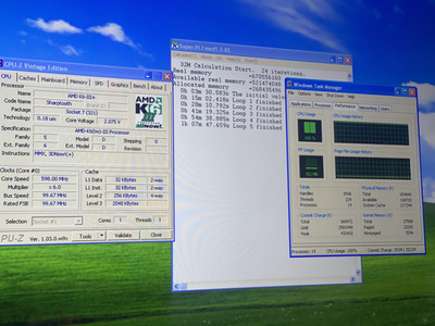

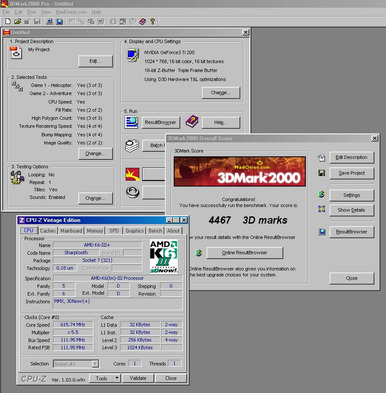

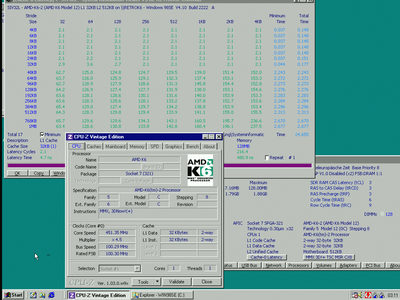

A return appearance of my k6-2+ 570 from earlier in the thread. I turned my Aoyue (I have no idea how to pronounce that) soldering iron up to its max temp, added some solder, then held it against the resistor with some sideways pressure. It surprised me that it came off as easily as it did (you can see a diagonal line where my soldering iron's tip dragged across the surface after it let go).
I had been fooling with my Soyo 5EMA+ and my K6-2+ 550, and the board was already set to 5.5 x 112 @ 2.2 volts, so I left the settings as they were, and popped this in. It booted right up, and was recognized as a K6-III @ 616. I got to the desktop with no problems, then ran 3D 2000. It CTD, so I assumed it needed a little more voltage, and set it to 2.3. It again CTD before completing the run, so I tried reducing the voltage to 2.1 and the bus to 100 MHz, and that did the trick; 3D 2000 completed with no issue. I then tried 5.5 x 112 again, and it again completed it with no issue, delivering 400 more points (4,400) than the K6-2+ had with all else the same.
The cache on this board won't work with the 124 MHz bus, so while 620 MHz gives the best memory performance as measured by Sandra, the 3D 2000 score had always been lower with a K6-2+. I really wanted to try a K6-3+ at this speed, but the 1.6 volt 400 I have will not go this fast. So now I was finally able to try a K6-3+ at 620 and find out if that extra 128k of full speed cache could make up for having to disable the 1024k on the board. And the answer was no. 5 x 124 delivered a score of 4,100, so about a 300 point drop.
It wouldn't POST @ 5.5 x 124 even with the voltage set to 2.4. I got it to POST once at 6 x 112, but it mostly wouldn't. I wonder if this board can't supply the power needed for these overclocks? I'll have to try these settings again with my Epox MVP3G-M and this CPU.
Congratulations to Sphere for pursuing this. I mostly didn't think it was possible because I was sure that if it were, it would have been discovered decades ago.

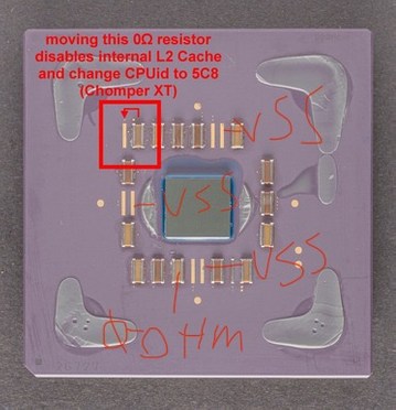

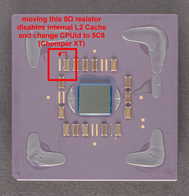

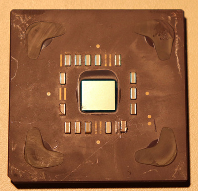

Today I moved the upper left resistor. The L2 cache was completely disabled and the CPUid got the number 5C8 (it's a Chomper XT now) 😀

Reply 263 of 600, by Sphere478
Repo Man11 wrote on 2022-03-06, 01:43:
A return appearance of my k6-2+ 570 from earlier in the thread. I turned my Aoyue (I have no idea how to pronounce that) solderi […]
Thanks Repo!
I’ll add this reply to the OP list under 570acz
Btw, don’t feel too bad about your results, actually they are quite good results. I can’t really do much other than the same with my 550 3+ (original oem 550 3+)
Fritzchens Fritz wrote on 2022-03-06, 02:43:
You have got to be kidding me…
Does this mean there are more out there that may be able to be modded?
Edit:
https://en.m.wikipedia.org/wiki/List_of ... 6,_250_nm)
Okay, so if there were more models to unlock I would expect to see non plus cpus that are on the 180nm process. But I don’t see them.
Perhaps you have created a processor that amd never released?

Reply 269 of 600, by Fritzchens Fritz
Sphere478 wrote on 2022-03-06, 03:02:
You have got to be kidding me… […]
Yes and no, I saw in a couple of earlier posts the question of what happens when the other caps are moved. So I gave it a try. That the L2 cache can be deactivated in this way is quite interesting but completely useless and does not open up any new usefull mods. Only the top left and the bottem right cap is a 0Ω resistor all other caps are capacitors with round about 15nF or 470nF.

Reply 272 of 600, by Fritzchens Fritz
Sphere478 wrote on 2022-03-06, 04:11:
Btw fritz, what equipment/method/settings temps/wattages are you using to move those resistors, your work is very clean.
-pre tinning gold pad with solder iron
-CPU with the pins on a camping hotplate at 180°C - 200°C
-Hotair station at 240°C (low air speed)
-some flux
-waiting 30 - 60 seconds and the resistor can be moved very easy with a tweezer

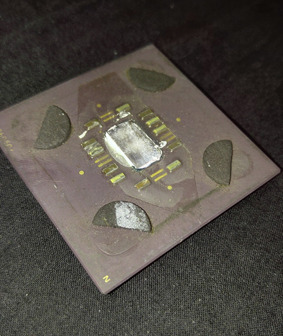

Reply 275 of 600, by Sphere478

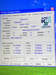

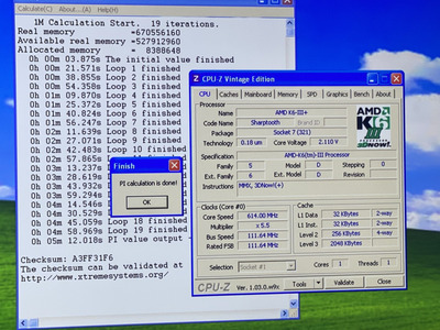

BitWrangler wrote on 2022-03-06, 04:45:
Grabbed these in dollar store earlier, gonna try them for levelling pads (like Athlon XP) ... regular stick-on foam feet are too thick usually.
Interested to see how it works out, but I really think the effort should be to put the ihs back on.
These dies are too brittle.
Edit:
Trying to figure out how well the k6-2+ to k6-3+ mod is holding up.
I got the ihs reinstalled, and it’s running super pi 32m at 600mhz no issues, I suppose that means that the adhesive I used is conducting well..
I ordered adhesive from ebay but they only sent 1 tube of the two tube epoxy… so I was forced to use the adhesive as the thermal medium as amd did.
The adhesive I used isn’t as hard as what amd used. So I’m still trying to figure that out.
You just left your resistor off I take it?

Looks like we have another 570 success story.
This is my second 570 that is stable at (at least) 600mhz unlocked.
Edit: 616mhz 112fsb lookin good, edit2 inconclusive, thinkin 112 is giving agp issues.

Reply 278 of 600, by Tetrium
Fritzchens Fritz wrote on 2022-03-06, 04:01:
Yes and no, I saw in a couple of earlier posts the question of what happens when the other caps are moved. So I gave it a try. T […]
Sphere478 wrote on 2022-03-06, 03:37:
Fritz, do you have a k6-3 non plus you feel like playing with?
Yes
Did I mention it's not my first rodeo? Here's a K6-2 I was playing with 20 years ago, probably my second rodeo. Had to shave those pads down after finding they were too thick. Note it's wearing a scotch tape "bib" to keep thermal paste off the discretes. Think this is a non-CXT 350 I was trying to get 400 out of. Still has all it's corners, just needs a cleanup, but wanted to leave it looking like I didn't just do it this morning....
