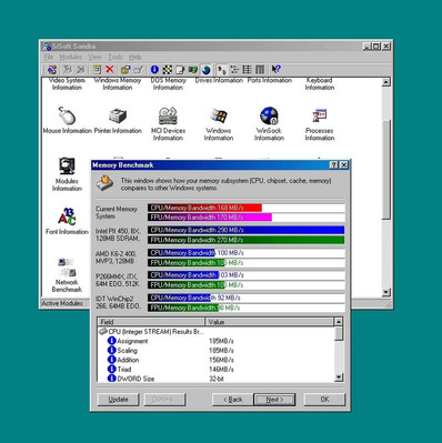

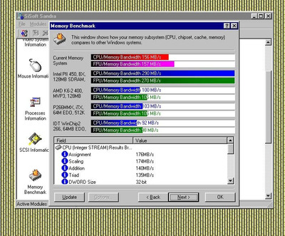

Compare the memory bandwidth of the TX Vs. the MVP3. The MVP3 is running 112 MHz FSB against 83 for the TX, has 1024k L3 (the L3 is disabled on the TX because with that much memory and the K6-3+ the score is lower with it enabled) and it has four way interleave enabled, while the TX doesn't have that feature.

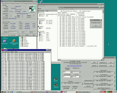

So, the 570ACZ running very well with the full amount of 256KB L2 cache.
672MHz (112x6) @ 2.1V with Water and activated L3 cache
682Mhz (124x5.5) @ 2.2V with Water and no L3 cache
700MHZ+ are not possible (even with 2.4V)

On both of my MVP3 boards the motherboard's cache works fine at 112 MHz FSB, but no higher.
