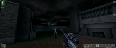

Sorry 3dfx Wide Driver 1.1 i did Try 1920x800 and 1680x720 Heavy Metal Fakk2 version 1.2 The Card is a Changeling 5500 PCI with HDMI
if I disable the mesafx force 16bit rendering and 16bit textures it starts with the lines
if I do not touch these settings it works
the purple lines will start at 1600×1200 if I disable mesafx force 16bit rendering and 16bit textures

At higher resolutions and 32bit colors, sli starts to "break" and you will see pink lines. This happens at 1920x1080x32 and 1600x1200x32. Using 16bit works for both of those resolutions(should). 1920x800 should be fine in both 16/32bit.
Reply 83 of 98, by Nuka-Cola Quantum
i found a way around it if my desktop resolution is 1600×1024 then 1920×800 or 1680×720 works with 32bit don't ask me why

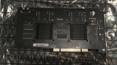

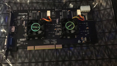

by the way My Card Came with the upgrade Cooling I like the Look

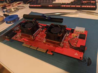

So... Tried 20mm tall fans.
352.35 KiB
624 views
Cant comment how they affect temperatures, cus I havent measured, they do seem to help keep it a bit more stable on my "breaking point OC". A bit louder than 10mm talls, so ... Think the main benefit is their distance from the heatsinks, so they dont recycle their own warm air. For now they can stay. Maybe they will change their sound profile in time (10mm have).

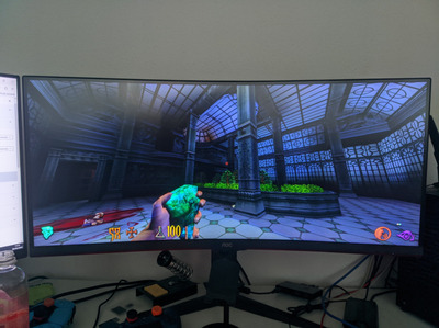

And I finally found a weapon(fov) position fix for Undying that works with 21:9 (here), so yay... Little victories!
