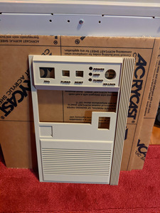

Overall size of the case faceplate is roughly 275mm tall by 175mm wide. I just printed it and gave everything a rough test fit. It is by no means perfect, but should go together ok if you have a well calibrated 3D printer. Minimal to no sanding/filing/drilling out required.
It features a single 5.25" bay and a single 3.5" bay, turbo display, turbo/reset buttons, keylock switch, rocker power switch, turbo/power/hdd LED's. It is somewhat miniature, designed to fit easily on a 300 x 300mm print bed. I'm using the Longer LK5 Pro 3D printer I picked up for $188 shipped from Aliexpress on their 11/11 sale. The filament I used is Printed Solid Jessie #500 -- an Amiga 500 retro beige.

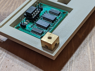

Turbo Display: ATTiny85 2-digit Turbo Display -- Re: Fabricating a New Turbo Display

Mounting Hardware: M3 screws, 10mm x 10mm x 10mm M3 mounting cubes -- https://www.aliexpress.com/item/1005001307756906.html

After printing, you'll need to install the buttons, switches, drive bay, etc. The drive bay may need a little bit of edge filing and brim cleaning (ymmv), then it can be glued in place. The 6-way threaded cubes can also be glued into the cutouts on the back side corners of the faceplate. The cubes will allow you to screw 1/8" thick acrylic or the cover shell STL to make the rest of the case. The length of the rest of the case depends on your motherboard size and add-in ISA/PCI/VLB/AGP/PCIe cards. Just note the drive cage size so your cards don't get blocked by it. If using a small Baby-AT motherboard like a Zida Tomato, the side panels need to be at least 16 inches long. With a 4-ISA SBC backplane, you can keep it to 10-12" long panels which cuts down a lot of cost.

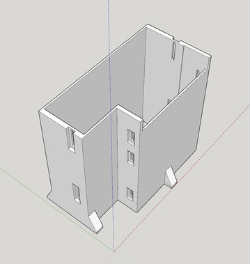

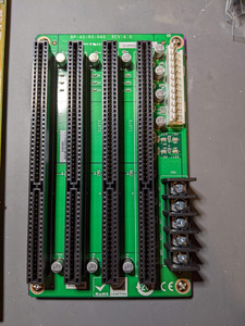

The U-shaped cover shell has been added to the ZIP in the second post. This is designed to fit on a 300x300mm print bed, and will likely only fit SBC backplanes. You may get lucky with some really small Baby-AT boards fitting if the CPU/RAM is low enough.

STL and Sketchup source files for the faceplate, drive bay, 3-sided shell, and standoffs. Backplate needs to be designed based on your motherboard/SBC specifics. The left side is left open so you can cut a piece of acrylic to fit in the opening for a clear window.

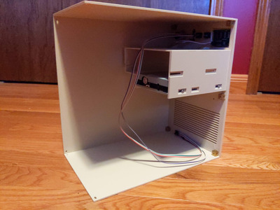

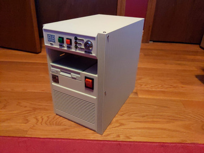

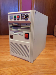

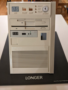

This is how it will look once you print & assemble the items in the ZIP file:
478.7 KiB
2308 views
500.33 KiB
2280 views
With 5.25" floppy mounted:
568.75 KiB
2280 views

Reply 4 of 81, by wiretap
No, it is made to DIY your own acrylic (or other 1/8" thick material) enclosure on the back side.
I put cutouts for 10mm cube mounts on the back.

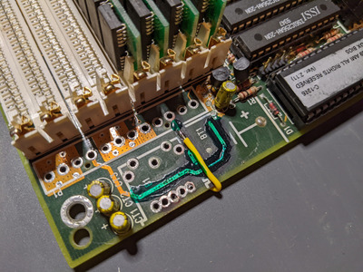

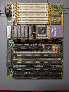

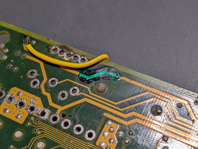

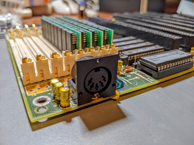

Waiting on some Aliexpress buttons and switches to finish up the front panel.. Grabbed a $30 motherboard. PC Chips M326 v5.2. It gets through some of the POST, but fails before it gets to a memory check. The battery corrosion got under the AT 12-pin connector and ate away the 12V pin and trace, and the keyboard connector. I was able to clean up everything, reapply solder mask, and run a new wire (24ga)to the back side of the board. I also replaced the keyboard connector. Still waiting on the new AT power connector to arrive from Mouser.

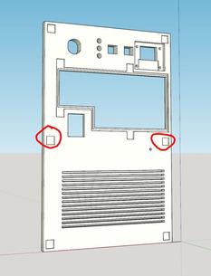

Reply 8 of 81, by wiretap
Depending on the 5.25 and 3.5 bay device selection, it can get quite heavy hanging off the faceplate and cause some bowing outward. I have revised the faceplate to include 2 more cube mount locations to hold the faceplate to the side panels to prevent this. If you already printed the rev2 faceplate, you can just superglue some of the cube mounts to that location.
Design files updated in post #2. (only the faceplate was updated to rev 3)

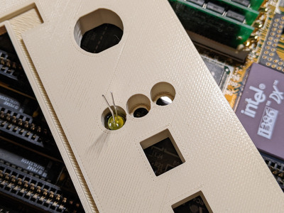

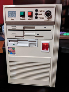

Test fit with all the parts.. the only thing that doesn't fit is the LEDs inside of the LED retaining rings. I need to make a cutout on the backside to allow for expansion of the retaining rings once the LED is inserted. I'll work on that soon and upload the revised model & STL files.
For the parts, I might switch over to a black surround to the red power switch. It seems like it would go with the reset button, turbo button, and LED surrounds a little better. The white is a little too bright. But I do like the switch. It has a huge "thock" to it when switched, and the travel distance is pretty decent.

Rev 4 is printed.. LED holder fits great now. I just have to print out another drive holder and verify the fit, then I'll upload the final rev of this case faceplate if it is all good.

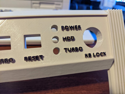

Reply 13 of 81, by wiretap

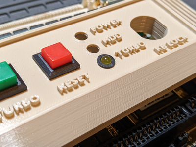

Did a little test on an old rev print. The lettering on the button panel can be marked with sharpie.. turns out ok. Looks excellent from more than a foot away. Other markers may be more suitable, or even some sort of dye/paint if you could apply it cleanly enough. Or you could always take the sketchup model and export everything to STL on the faceplate except the text, then print the text seprate in a different color and glue it on afterwards. (or obviously print in 2 colors if you have a dual head machine)

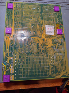

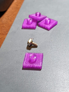

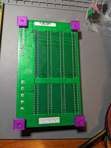

Added some motherboard standoffs to the 2nd post in this thread. They can be stuck down with automotive grade 3M sticky tape, or superglued in place. I'm using them by screwing them to the board first, then laying the board where it needs to go and marking the mounting locations for where the standoff mounts sit. Then superglue them in place. They are a tight fit with 6/32" screws, and also fit M3 screws, but don't overtighten.
