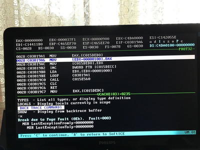

I got Win98 working on h87 performance with i5 4690k and 16gb ram and ati x600.It boots from win98 from usb and sata.
On z690 ud ddr4 with i7 12700k, 32gb ram(tried with 16gb ram too, does not work).It does not boot win98 from usb nor sata.
Disabled cores, lowered cpu and ram clocks, etc and it still does not work.
(normal boot or safe mode its the same error)(with ram limit in system.ini and himemx.exe with ram limit)
I get vcache protection error.
bootlog ends at: "[00142D3F] DEVICEINIT = VCACHE"
Saw a video with a russian guy getting the same vcache protection error on z390, he then used an adapter and 2gb ddr4 sodimm and it was the same.
I installed softice(I don't know how to use it):
    268.03 KiB
    1729 views

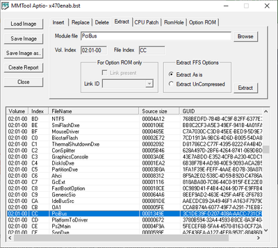

Well, I ran into VCACHE Windows protection error yesterday, after a BIOS upgrade on my Biostar X470 GTA/Ryzen 3900x/Vooodoo 3 PCI. Windows 95A, 98SE & Me all returned this error with no hardware change. As soon I reverted to the old BIOS all 9x systems worked great again...
So clearly something is breaking the compatibility with Windows 9x at BIOS level and it's not an actual hardware incompatibility...
Almost all consumer motherboards are running AMI BIOSes now. (Are there any new motherboards with Phoenix BIOS?)
The good part that there are official tools to fiddle with AMI BIOSes. AMIBCP to enable/disable menus and options and MMTool to insert/extract BIOS packages. Back to my motheboard, the old „PciBus” section had 79KB, but the latest version has only 75KB. Maybe I can reuse some old packages with a new BIOS release. In my case the reason for upgrade is Ryzen 5000 series compatibility.
Anyways, I'm almost sure that VCACHE error it has something to do with RAM, because I saw on a socket 1200 motherboard some legacy settings concerning the RAM operation. (unfortunately I don't have that board anymore)
    26.04 KiB
    1674 views

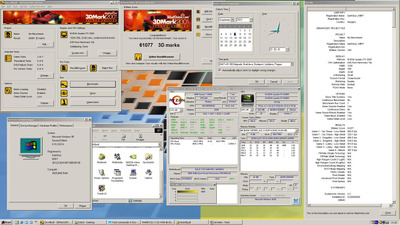

Reply 6 of 13, by OMORES
Good news! Now you can install Windows 98 even on Intel Raptor Lake configurations using a tiny patch named `cregfix`. (5 min video)
It looks like the solution was found by a guy "mintsuki" (probably him: https://github.com/mintsuki)
... after the page fault triggering the VCACHE issue, noticed that the cause of the page fault was a write to a non-writeable page while executing in ring 0. This behavior can either do nothing (if CR0.WP=0, which is the default setting outside of this OVMF/CSM version of legacy booting), or trigger a page fault if CR0.WP=1.
*A little more info on this blog.
The whole patch takes the form of a 33 bytes executable... which must be loaded in autoexec.bat
The rest of the Windows 98 installation is the same business as usually. On my test configuration (Asus H610 CSM/i3-13100F), everything was completely stable.

Reply 9 of 13, by OMORES
MrMateczko wrote on 2023-11-14, 14:13:
Rebooting will not work, but shutting down and using Ctrl+Alt+Del at the Safe to shutdown screen is an easy workaround.
It think this is an issue with your specific build/software, because I can restart and shutdown normally on my configuration: H610/i3-13100F/Radeon X300. BTW, Windows 95A is working smooth with this patch.
What nVidia drivers are you using? Can you leave a link? I use "Tweaked Unofficial NVIDIA Display Driver 82.69" (MDGx) but I get mixed results....

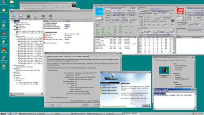

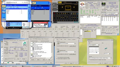

Reply 11 of 13, by DarthSun
@MrMateczko
@ OMORES
Lmouse useful information, I will try it. A PS2 mouse works, but a USB one wouldn't hurt, the latter is ok under DOS, I also have a bug under Win98.
USB keyboard: indeed the legacy BIOS handles it well.
SATA AHCI: works fine with Loew drivers.
QFX3450/3500-7900GS-6800GS: also ok with the modded NV driver.
32GB RAM : Loew memdriver, no problem.
Audio: PCIe->PCI/SB060 - DOS/SBEMU - Win98: native driver from the CD.
VCache: it didn't appear for me, I have an old BIOS on the B450, but CRegfix may be useful for others.
382.14 KiB
881 views
343.61 KiB
881 views
