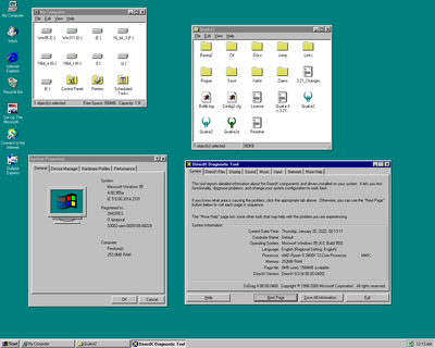

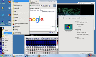

I experienced Windows 95 on a Gateway 486 DX2/66/8MB, and I always wonder back then how fast would run Windows on the fastest computer available... That's why I'm still installing old Windows OSes (98SE especially) on much newer, *unsupported, configurations. (Don't worry, I also love to play with old hardware.)
I already have some topics on NT 3.51 and 4.0 which are running fine on a Ryzen 3900X.
Recently, I installed Windows 95 on the same configuration. I discovered that, after installing manually the PCI bus, you have to delete from registry the old entry for the video card or else drivers won't install... I would like to share stuff like this on a dedicated section...

1541 wrote on 2022-01-26, 18:23:
I guess you needed the FIX95CPU patch from
http://lonecrusader.x10host.com/fix95cpu.html to install Windows 95 here?
That patch is a thing for Windows 95 OSR2. The first edition ("A") can be installed normal on a 4ghz CPU, you just need to edit system.ini to limit the RAM amount and you'll get straight to the desktop without any hitches. (at least on my configuration)
Initially, the video card is recognized as a "standard device" but you can't install drivers, you need to install PCI bus, delete the old registry entries for the video card and that's it... On my computer, Windows 95 is fully functional: with sound, video, LAN, and BIOS access to SATA drives. (any FAT16 partition within first 8.4GB is available, including those on NVME)

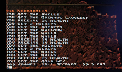

O and please try quake 1 in software mode with highest settings. 😁
95.9 fps @640x480 Quake 1 DOS version in Windows 95 using philscomputerlab DOS Benchmark Pack

Reply 7 of 14, by Joseph_Joestar
OMORES wrote on 2022-01-27, 21:24:
Joakim wrote on 2022-01-26, 20:21:
That's kinda low. My AthlonXP system gets 98.7 FPS in Quake 1 software mode at 640x480 with all settings maxed out.
I am using FASTVID though, not sure if that's applicable to modern systems.

But the problem is, I can't install any driver. No sound, video is at 640x480 only. New hardware isn't detected. I'm guessing it has something to do with the removal of the Plug-and-Play BIOS system device. Any ideas on how to solve this?
Reply 14 of 14, by OMORES

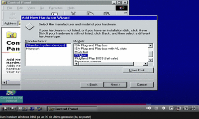

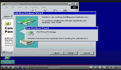

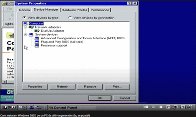

WarPath_2020 wrote on 2022-05-03, 23:38:
If everything looks clean in Device Manager (see the screen shot attached), with no unknown/other devices then you have to install manually the PCI bus.
This operation may take a while, do not restart when asked and continue to install all devices. For system devices like "PCI to PCI bridge" go with default Windows drivers. For specific hardware like a network card you can provide the actual drivers.
The video card was recognized before adding the PCI bus as a system device, and now will show up again... this is a problem, because Windows will stick with the original registry entry for the video card. The newly discovered video card will have an exclamation mark. You have to delete the initial Standard PCI Graphics adapter from control panel (or registry) and then some magic will happen: drivers will work...
