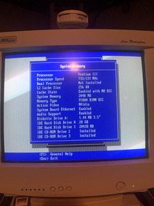

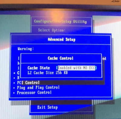

Hi to all readers I just had a couple of questions that I was hoping the people of Vogons could help answer. I recently got my super 90’s computer up and running but I am having some problems getting windows 98se installed. My motherboard is a 0r840 dual slot board. When in the bios I have configured it to look for my cd drive first. The version of windows 98se I got was sealed and when I opened it it only had a cd and no boot floppy. Idk if this was a manufacturing error or if some versions of 98se don’t need one. But no matter what I try my computer keeps asking for a floppy.

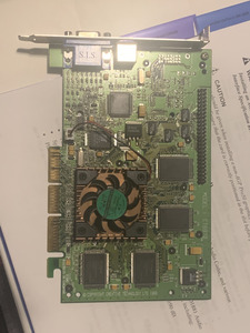

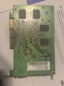

Second: the graphics card I would like to use is a GeForce 256ddr. However I have only gotten that to run once. Every other time it bugs out. I have since out in an Nvidia Quadro 2 mxr and it’s been working fine. However I wanted to only allow parts from the 90’s any Tec past that is supposed to be off limits. Any ideas on what could be wrong with my graphics card?
904.27 KiB
1483 views
Thank you all for any help. It’s really appreciated. I’m not really good at this stuff but it integrities me and I feel I’m slowly learning.

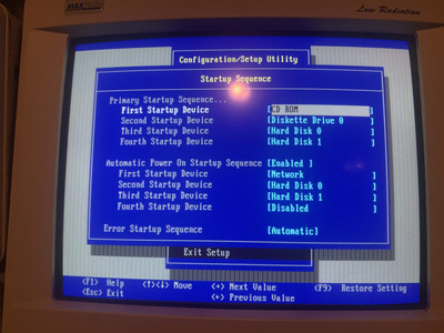

Reply 4 of 17, by PC Hoarder Patrol
Xray1281 wrote on 2022-02-01, 05:56:
debs3759 wrote on 2022-02-01, 04:41:
Xray1281 wrote on 2022-02-01, 02:05:
Is the battery saving the CMOS settings? ie has it saved the BIOS setting to boot from CD?
Yes it’s saves all my changes. I have even gone as far to make it not even register the floppy drive but it still won’t work

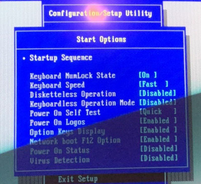

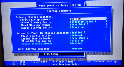

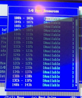

You really can't catch a break with this, can you!

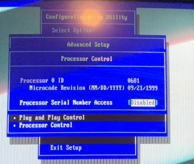

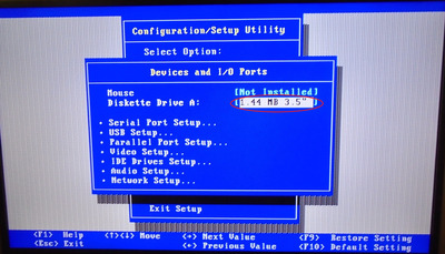

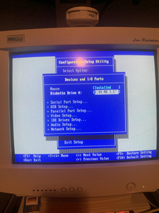

I've just chucked the following setup onto the test bench to try and figure the problem - IBM 6868 mb, 2GB RDRAM, 1 x 1000/256/133 Slot 1 cpu, Matrox G400 Dual Head, 6.4 GB IDE hdd, IDE CD-ROM & 1.4MB floppy. Boot priority is set to CD then floppy then hdd. Using 98 boot media on all devices, the setup always boots from the correct device, depending on whether the floppy disc and / or CD disc is present in the respective drives.
Guess the next thing to check is how you have your setup configured - this is mine
834.28 KiB
1414 views
988.28 KiB
1414 views
721.03 KiB
1414 views
Assume 'Devices and I/O Ports' is where you disabled it at your end, and no floppy is mentioned anywhere on the 'Startup Sequence' page.

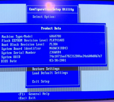

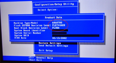

Last thought for now would be a BIOS version issue - can you check yours is the same as mine (believe this is the latest for this board version)

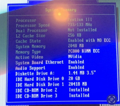

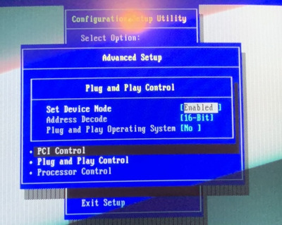

Reply 5 of 17, by Xray1281
PC Hoarder Patrol wrote on 2022-02-01, 10:38:
You really can't catch a break with this, can you! […]

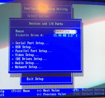

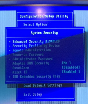

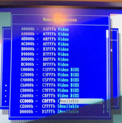

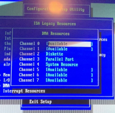

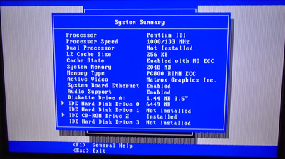

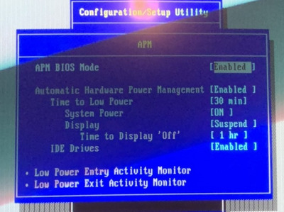

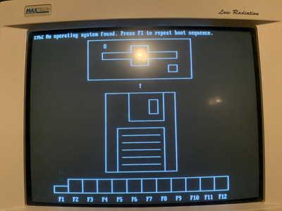

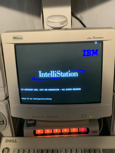

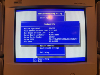

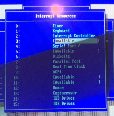

I have mine set to yours my bios version does seem to be a bit older here are some photos of what happens when I try to boot. It says media test failure at one point but idk what that would be when it picks up everything in the bios. I also get error 103 it says my processor speed is too high and moves it dow to 200MHz. Idk if that’s just for when I’m in bios or why that happens.
Reply 7 of 17, by PC Hoarder Patrol
Xray1281 wrote on 2022-02-01, 17:39:
Here’s the start up sequence settings
OK, suspect the 103 error was introduced with the BIOS you're on (v41) and was fixed again with v43, so in that case you might as well update the BIOS to the same as me (v44) which you can download here
https://www.ibm.com/support/pages/flash-bios- … -type-6868-6878
For reference, the full BIOS history is attached
IBM Model 6868 BIOS Notes.txt
3.75 KiB
47 downloads
Once that's done maybe the other issues might resolve themselves or we can investigate further if not.

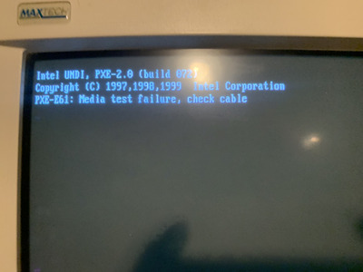

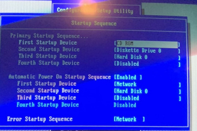

Thanks. I got everything onto a floppy but it seems that the reason nothing will read is that error
pxe-e61 media test failure. I’m not sure how to fix it. Trying a few things if you have any tips or suggestions I’m open to it…
Reply 11 of 17, by PC Hoarder Patrol
Xray1281 wrote on 2022-02-07, 23:01:

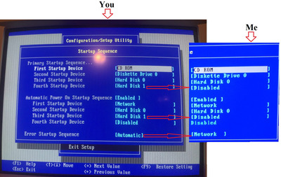

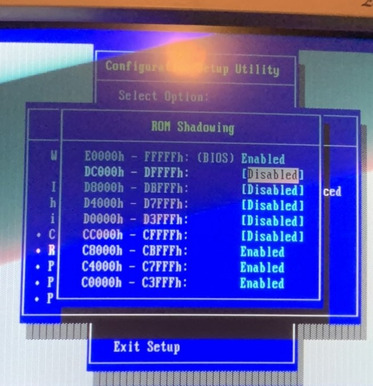

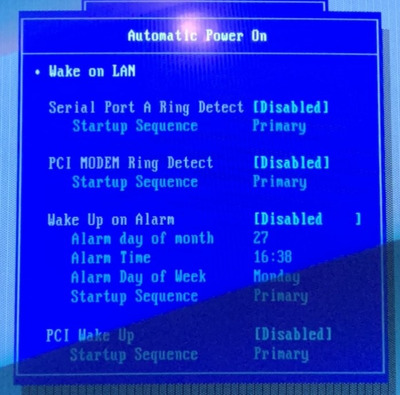

The error just means that for some reason the device seen at the end of your boot sequence is the on-board network adapter ( https://www.intel.co.uk/content/www/uk/en/sup … top-boards.html ). Can only assume this is still an issue with your startup sequence, so try the following...
- change your sequence to exactly the same as mine (see arrowed entries in attached pic) then save / exit from the BIOS and try booting from the floppy again
- if that doesn't work, go back into the startup sequence and change both 'Automatic Power On Startup Sequence' & 'Error Startup Sequence' to Disabled then save / exit from the BIOS and try booting from the floppy again
Let us know if either changes things. Also, as a matter of interest, how are you powering on the system - does it start as soon as you switch on the PSU, or do you have a on / off button connected to the front panel connector (the white one between the secondary IDE & floppy headers)

Reply 12 of 17, by Xray1281
PC Hoarder Patrol wrote on 2022-02-08, 09:38:
The error just means that for some reason the device seen at the end of your boot sequence is the on-board network adapter ( htt […]
Thanks for the help. Looks like it’ll be awhile. The ide cable I bought broke. The bit connected to the motherboard actually snapped off. Seems to have been cheap so I ordered from a different seller. Will update when the new part comes in… When it comes to the power the two buttons on the front are just a simple power switch and a reset button.

Reply 17 of 17, by PC Hoarder Patrol
Xray1281 wrote on 2022-02-27, 22:56:
Finally got the new cable in and was able to set it up. Tried what you had and it still didn’t work. Idk why it’s acting this way. Could it be because I have both a 5.25 and a 3.5 plugged in? Either way I took photos of everything. I reset to the default bios settings and then put it back to what you had. I just took a photo of everything because I’m so lost on what I need to do to get this thing running…
Not sure what else to suggest at this point - the board interface only supports one physical floppy drive (3.5") but I did check on mine with both 3.5" & 5.25" connected anyway and it made no difference as my board still boots correctly.
Guess the best option now is to try and complete the BIOS update and see if that helps - I misremembered re running the update from a hard disk, as although the file I linked earlier will only create a floppy boot disk you can then copy the files from there onto a hard disk and run the update from there so somehow you need to -
- create a bootable DOS hard disk
- copy all the files from the floppy onto the hard disk
- connect the hard disk to your board and make it the only available boot option
