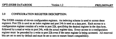

No programming is needed but you need datasheet for the chipset and you need to find control ports and indentify registers involving shadow RAM. Index port is used to select chipset register. Once it is selected the data port is used to write data to or read data from that selected registers. These two ports must be specified in the script file but then makhiset.exe handles the rest. For OPTi496 those port are:
29.05 KiB

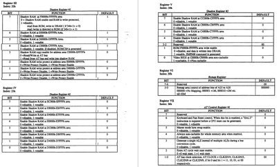

It should not be too hard to identify the shadow RAM registers. There should not be too many. There are three registers on OPTi496 but we really need just two of them. But I included the third one as well (34h).

I won't explain real mode addressing here or PC memory map expect that VGA BIOS is usually 32k and always at segment C000h. So first segment for next ROM would be at C800h. System BIOS starts from F000h segment so our ROMs and UMBs must be within C800h - EFFFh. In this system we have 8k build of XTIDE Universal BIOS at segment C800h (-C9FFh). So that leaves CA00h-EFFFh available for UMBs.
In the script file INDEXPORT=22h tells the address of index port and DATAPORT=24h tells that data port is port 24h. First chipset register we need to modify is register 32h. We select it with INDEX=32h and configure it with DATA=xxxxxxxxb. So every bit needs to be configured to 0 or 1 or x. X means no change.
We should modify the registers so that we do not override the actual shadow ram settings configured in BIOS setup. We just want to write enable the unused areas so they can be used as UMBs. The first register 32h shows one limitation about this chipset. We can only write enable 64k blocks of RAM event though there is much finer control for shadowing ROMs. Since we always have VGA BIOS at C000h, we must always write protect whole C000-CFFFh. So only D000h-EFFFh are available as UMBs. So having XTIDE Universal BIOS at C800h did not limit our UMBs at all! In fact, we could have total of 32k of ROMs in addition to VGA BIOS and we could still use all the UMBs this chipsets can provide. This shows the importance to properly set the expansion ROM addresses. Start to place them after VGA BIOS and do not leave gaps.
But how to modify register 32h? We set bits 6 and 5 to enable shadow RAM for 64k segments E000h and D000h. Actually it is (UMB) RAM now since we have no ROMs to shadow there. Then we need to clear bits 2 and 3 to write enable those segments. Everything else should be left to x (unchanged) but I set bit 0 to 1 to notify our VGA BIOS needs to be write protected.
Register 33h is easy. We set every bit to 1 to enable those same memory areas we just did at register 32h. Only here we do it in finer 16k steps (for actual shadowing purposes).
And last register, 34h, could be left unmodified because it simply have controls for Cxxxh and F000h-FFFFh that we cannot use as UMBs anyway. But I made sure main BIOS is write protected (bit 1 set to 0) and I also set bit 0 because this system does not have video bios cacheable setting at BIOS setup. Yes, nothing prevents to modify other, UMB unrelated, chipset registers as well! I could, for example, modify memory timings since this system does not have those settings in BIOS setup.
Finally in the script file there is RAMINIT=D000h-EFFFh. It tells where we enabled the UMBs so the driver can use them.
