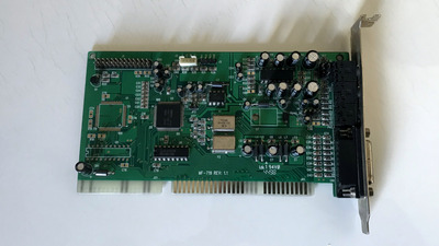

WTF I love C-Media now. Seriously though, this looks really cool.

Oh, and I have noticed that unlike every other CMI8330 or HT1869v+ based card that I have seen, this one actually has a 14.318MHz oscillator on board rather than sourcing that clock from the ISA bus. Is that a first for a card based on that chip ?
The one integrated on my PC Chips M571 motherboard has that oscillator too.
Maybe it was only the standalone CMI8330 cards that omitted it?
Since the the audio functionality is integrated on the motherboard on the M571, it would make sense to use the OSC that would need to be installed on the motherboard anyway in order to comply with ISA spec for audio purposes as well ( unless you meant that this motherboard has 2 such oscillators).
AFAIK, one reason for ISA cards often having their own oscillator was to avoid issue with out of spec motherboards . A properly designed and built motherboard with onboard audio would have no issues with there being a single 14.318MHz oscillator.
Issues possibly due to oscillator concerns :
MP3s slightly slower on old '90s pc with CMI8330
http://www.os2museum.com/wp/the-isa-osc-mystery/

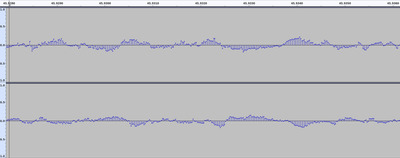

Just a guess based on a quick look at square.mp3 : mono track split (duplicated) to stereo, one side inverted. Results in a sort of "spatializer" effect, or "enhanced stereo" as some of the old boom boxes used to call it. With further uneducated (on my part) speculation that some frequency or phase 'issues' (or adjustments, if you prefer the term), as a result of the interacting channels, are a resulting 'compromise'. I've probably missed something but I don't have time for a fine microscope session.
Might I ask the purpose of the challenge?

Then inverting back one of the tracks should produce a track identical to the other.
Or in other words doing a "mix and render" from audacity on two identical tracks with one of the two inverted should produce a total silence.
Which is not exactly the case. But inverting one track results in almost the other track which makes me think if this is because of the compression, or there is something more. WAVs would clarify this point.
I'm also wondering what we're supposed to spot here.

Indeed. At a moderate zoom level, the visual waveform appears approximately inverse. But at a more microscopic zoom, differences become apparent. I'm not sure if we're picking at straws here due to compression, or missing the point entirely.
116.05 KiB
1535 views
Audacity - Moderate zoom
116.26 KiB
1535 views
Audacity - microscopic zoom
Probably the latter. There's more going on here.
