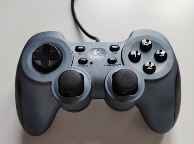

Finally decided to take my Logitech RumblePad 2 out of storage and hook it up to this machine. I bought this gamepad around 2005 or so, and have kept it ever since. It still works fine to this day.
194.24 KiB
1920 views

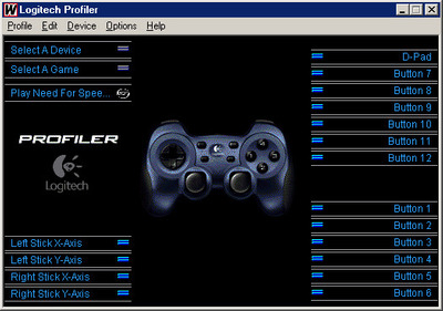

I have an old version of the Logitech Gaming Software (lgs460enu.exe) which can be installed under WinME and probably Win98SE too. It even has preset profiles for some Win9x era games like Tomb Raider 3 and Need for Speed: High Stakes.
66.32 KiB
1920 views
The gamepad worked great with NFS:HS, and even force feedback was enabled and functional out of the box. The rumble effect was a bit too strong by default, but thankfully, you can fine tune it using the in-game controller options. I imagine it was designed for Microsoft and Saitek's force feedback joysticks from that time period, and probably feels much nicer on those devices. Anyway, I really enjoy playing racing games using the gamepad's analog sticks. It feels much more natural to me than using the keyboard.
That said, this gamepad really shines with PlayStation ports like Final Fantasy 7 and 8. It's possible to set up the game's controls to perfectly match the PlayStation layout. This is great for people who have played those games on consoles and have tons of muscle memory associated with that controller. And with some manual tweaking, you can map the analog stick for movement, while still using the D-Pad for menu navigation. Absolute perfection!
Lastly, I tried a couple of DOS games as well (from within the WinME DOS prompt) and they worked fine too. Both Tyrian and Descent correctly detected the gamepad and could use it without any additional tweaking. I do have a CH Flightstick for DOS gaming, but it's nice to know that the RumblePad 2 can be used as an alternative in some cases.

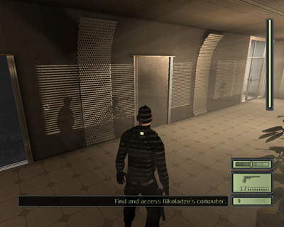

Having recently played through a SC:Conviction and SC:Double Agent, I decided to revisit the original Splinter Cell on this system. One of the reasons why I got my GeForce FX 5900XT was to improve performance in that game. Last time I played through Splinter Cell, I was using a GeForce 4 Ti4200, and it ran fine at 800x600, but performance went down steeply if I raised the resolution any higher than that. In comparison, the 5900XT runs Splinter Cell at 1280x1024 with fairly decent frame rates.
280.34 KiB
880 views
I'm happy to report that my 5900XT does not suffer from the disappearing shadow bug which Phil demonstrates here on his 5950 Ultra. My card does have the shiny texture glitch that Phil shows a bit earlier in his video, but that one is far less intrusive. This is great, because the GeForce FX series are the last Nvidia cards which can correctly render all the cool Shadow Buffer effects in this game.
To me, performance on this card is good enough for a stealth game. At 1280x1024 with all in-game graphical settings maxed out (but no AA or AF forced in the driver) I get 30 FPS most of the time. This can jump to 60 FPS in smaller areas or fall to 20 FPS in places where there are a lot of Shadow Buffer effects. Still, this is reasonably playable for a period correct GPU which came out in the same year when Splinter Cell was released on PC.
For reference, I'm playing this under WinXP+SP3 using Nvidia's 45.23 drivers. Also, I'm using the retail CD release of Splinter Cell with the latest official patch 1.3 applied. No third-party fixes or mods are used.
