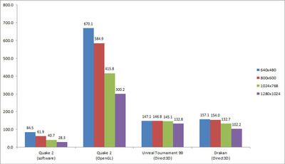

I'm thinking of switching to 45.23 Nvidia drivers. On this system, they reduce GPU performance by about 3% compared to 40.72 drivers, but in return, they give me aspect ratio scaling options over a DVI connection. This is useful for older games which don't support the 1280x1024 resolution natively, and need to use something lower. The "Fixed Aspect Ratio Scaling" option prevents the image from getting stretched:
79.87 KiB
2019 views
I'm also experimenting with Windows ME since it has slightly better driver support for newer hardware. For example, the VIA Hyperion Pro 4-in-1 524A driver can be installed without any issues under WinME. In comparison, the chipset component of this driver pack "fails" under Win98SE and you need to manually restart the computer in order for all the motherboard devices to install correctly. Minor issues to be sure, but I already have a different rig running Win98SE, so I though I might change things up a bit here. We'll see how it goes.

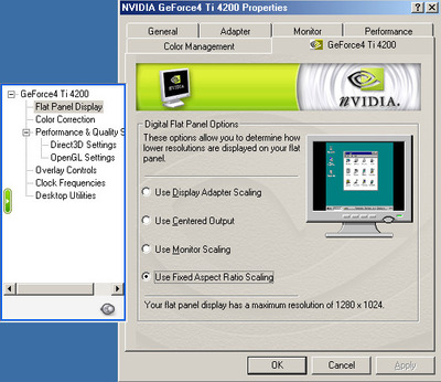

I never use DVI with these old nVIDIA GPUs, don't like the output quality (particularly in DOS/during POST).
VGA looks and works best for me (+ I get full aspect ratio control using my monitor's capabilities).
I did notice some blurriness when using non-native resolutions on Nvidia cards over DVI. This doesn't seem to happen when using a VGA connection.

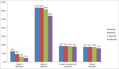

I did a preliminary comparison between WinME and Win98SE using the same Nvidia driver versions. As expected, there is almost no difference in performance between the two operating systems in that situation.
On the other hand, there seems to be quite a bit of difference between 40.72 and 45.23 drivers on this rig, regardless of whether WinME or Win98SE is used. The 40.72 drivers are about 3% faster in OpenGL and roughly 8% slower in Direct3D games. Despite that, 40.72 drivers consistently score higher in 3DMark 99, 2000 and 2001, which is very odd since those benchmarks use Direct3D.

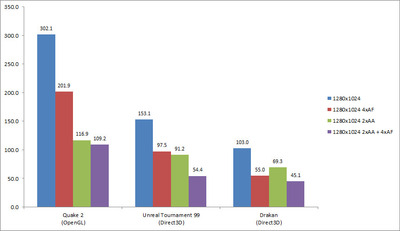

bZbZbZ wrote on 2022-06-07, 04:38:
Can you stay above 60fps on Quake 2 (GL), UT99, and Draken if you enable some Anti Aliasing? I presume your monitor is 1280x1024 @ 60 Hz...
On this rig, I can use Anti Aliasing and Anisotropic Filtering in moderation, but combining those settings with the 1280x1024 resolution lowers the performance of my GeForce4 Ti4200 quite a bit. Another chart incoming:
45.44 KiB
1747 views
Personally, I prefer to have some extra headroom so that my games don't drop below 60 FPS even in the most demanding scenes. This is why I usually play with both AA and AF disabled on this system. I do sometimes enable them for games which only run at a fixed, lower resolution (e.g. 640x480) or for older titles that aren't very demanding.
But to smoothly run late-era Win9x games with high AA+AF settings at 1280x1024, I would probably need something like a GeForceFX 5900XT or better.

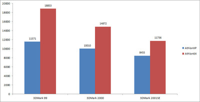

By popular demand, I'm uploading the GeForce4 Ti4200 benchmarks from my old AthlonXP 1700+ build and comparing them to this Athlon64 rig.

3DMark 99/2000/2001SE:
40.55 KiB
1623 views
As expected, the Athlon64 is able to draw out more performance from the GeForce4 Ti4200 than the AthlonXP. Naturally, the gap gets smaller as the resolution increases since the systems start becoming GPU limited. Still, it's interesting to see how much difference a faster CPU makes.

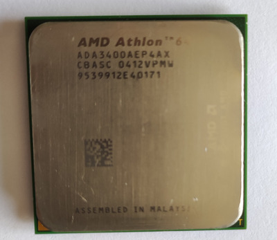

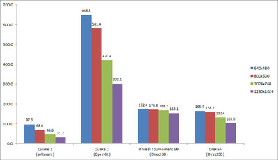

Slight upgrade:
118.61 KiB
1439 views
I replaced the Athlon64 3000+ CPU with a 3400+. Not a huge performance increase, but it is noticeable. In Deus Ex, I finally have stable 60 FPS on Liberty Island, and that is probably the most demanding level in the game.
BTW, this 3400+ uses the same NewCastle core as my previous CPU, since I'm not sure if the oldest BIOS for the K8V-MX can handle Venice. I won't be redoing the benchmarks yet, because I'm still waiting for a few things to arrive. Hopefully in a week or two.
