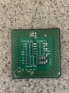

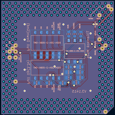

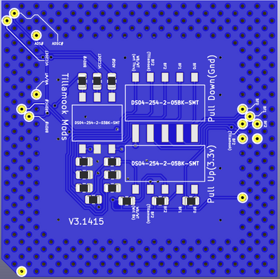

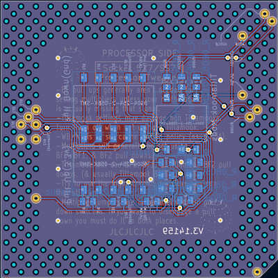

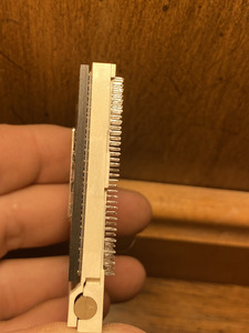

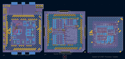

Similar to the original motherboard based tweaker, but this one goes between the processor and the socket
Useful for:
-Tillamooks
-Asus p5a 1.05/1.06 with k6-2+/3+ cpu
-Should solve any issues you may be having setting multipliers supported by the CPU.
Examples:
if motherboard is missing a pull up or pull down signal it can be hard to set many multipliers. on many socket 5 boards it's sometimes difficult to set 3x setting for pentium 200, or perhaps setting 4x, 4.5x, 5x, 5.5x on socket 7 motherboards. or 4x on Tillamooks, or 1x and 4x on Cyrix.
It seems .4 and .6 pcb thicknesses work pretty good. shown is .6 (different pcb project shown)
211.73 KiB
2481 views

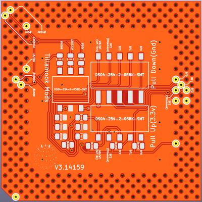

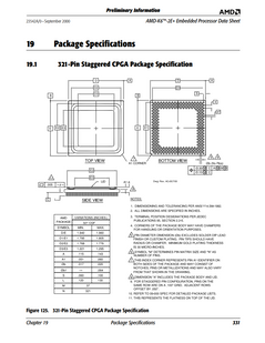

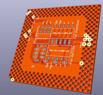

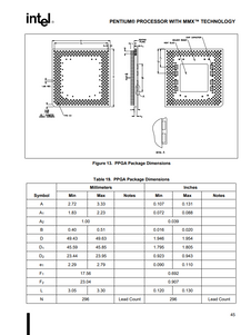

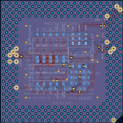

I've whipped up V3 as you can see below. The design isn't very complicated and not a whole lot to go wrong. The major thing that needs prototyped is the hole size.
I've included some data on pin size from the official datasheets: It seems typical pin size is 0.017"-0.020" I set hole size to 0.020" Alignment may be tricky. especially when trying to interference fit many pins. There is basically zero room for error on this particular. here is to hoping the first prototype hits it on the money. would be great to get the footprint from those winchip PCBs 🤣
I gave thought to making this a solder on device but it just seemed too difficult and a shame to permanently attach this to a processor when it could be removed and used across a whole collection. if someone wants to solder it on, that should be possible on a press fit setup if you wanted to. Perhaps using solder paste or thin solder and flux with hot air. Though I think it would be challenging.
Of course, order and use at your own risk.

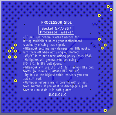

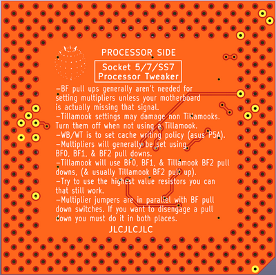

Reply 1 of 40, by Sphere478

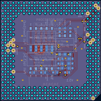

Note: known bugs, forgot to update the resistor values to their new locations after moving them from previous project. also noted one pad trace not routed. will follow up with update momentairily.
Alpha v3
    Socket 5-7-SS7 Processor Tweaker v3.zip
    3.21 MiB
    72 downloads
    511.03 KiB
    2491 views
    490.12 KiB
    2491 views

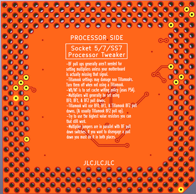

    296.91 KiB
    2491 views

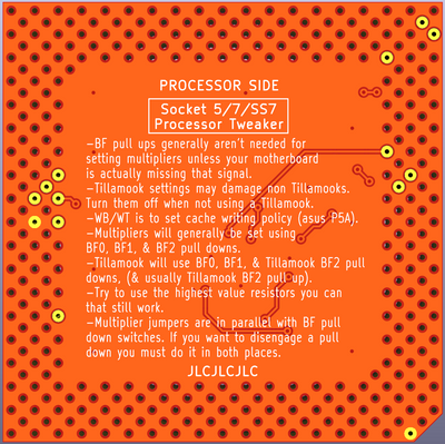

Sphere's PCB projects.

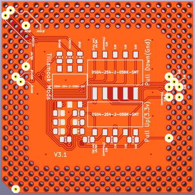

Reply 2 of 40, by Sphere478
Socket 5-7-SS7 Processor Tweaker v3.1.zip
2.29 MiB
74 downloads
Alpha v3.1
-Adjusted traces.
-Fixed non connected pad
-Updated resistor values
Edit: known bug need to flip resistor footprint to take vss off island
    438.24 KiB
    2460 views
    309.69 KiB
    2460 views
    273.45 KiB
    2460 views

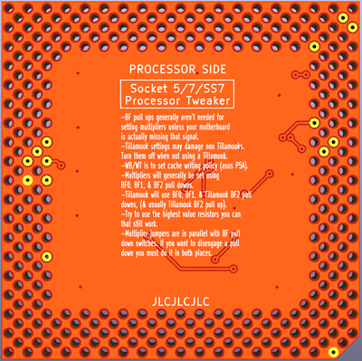

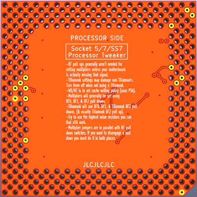

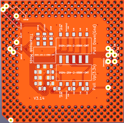

Reply 3 of 40, by Sphere478
2.34 MiB
69 downloads
Alpha 3.14
-Found island on vcc breaking connection to resistor. fixed.
-Tweaked a few other things. minor stuff
Edit: known bugs
-Via not on VSS net
-Trace in pad on VSS net
    525.29 KiB
    2454 views
    539.84 KiB
    2454 views
    233.52 KiB
    2454 views

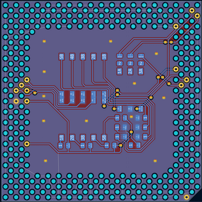

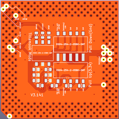

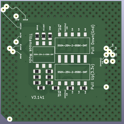

Reply 4 of 40, by Sphere478
might prototype this...
Socket 5-7-SS7 Processor Tweaker v3.141.zip
2.19 MiB
70 downloads
beta 3.141

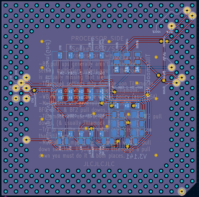

-Went through and painstakingly aligned the holes best I could.
-Made a best guess for passive hole size and interference fit hole size.
- Adjusted traces and footprints
-Connected "tillamook mods" switch pads to resistors.
-Enlarged writing.
Known bugs:
Tillamook bf2 silkscreen label
    386.15 KiB
    2398 views
    392.48 KiB
    2398 views
    338.61 KiB
    2398 views

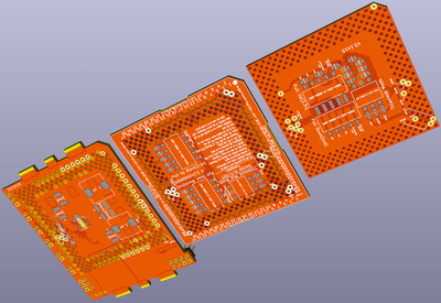

Reply 5 of 40, by Sphere478

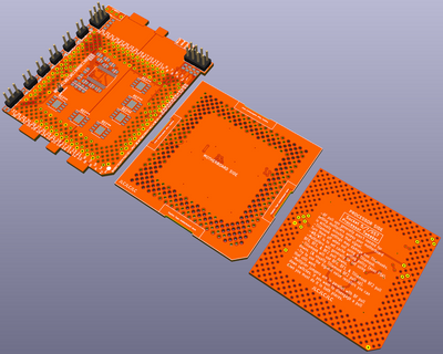

Re: Idt Winchip 1, 2, 2a and 2b differences
some better pics of the winchip version of this concept. There is also a version with multiplier switches but I can't find a pic. but same idea with the pcb sandwich.

My digital caliper bit the dust a while back, I found a mechanical caliper though and took some measurements on my socket 5/7 collection the pins seem to universally measure about 0.017-0.018” The latest beta still is set to .020
I’m debating on wether or not the tinning process will add enough thickness to the hole to make it a good press fit. I think It just needs to be ordered to find out, here is to hoping all the holes are aligned to one another. In the schematic they seem to be right on the money. But how that translates to a real world product we’ll see.

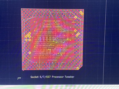

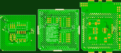

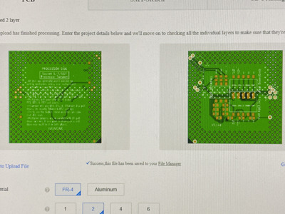

Having a hell of a time trying to order these.
Here is how it looks on my end:
1.76 MiB
2313 views
1.98 MiB
2313 views
And here is what jlcpcb sees:
1.75 MiB
2313 views
Idk what the heck is going on… and their “support” just closed after helping not a bit.

Reply 9 of 40, by Sphere478

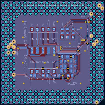

Beta 3.1415
Socket 5-7-SS7 Processor Tweaker v3.1415.zip
2.06 MiB
70 downloads
Still can't figure out why JLCPCB is glitching out the render.
-Went through and solved some DRC complaints, in hopes it would solve the glitch. no luck.
-Trace routing changed a little
-Moved tillamook dip switch a tad.

did A experiment:
when I paste all into the same pcb file and upload it, they seem to upload fine.
when pasting these I moved them around on the grid. maybe that's all I need to do? move it to realign it?

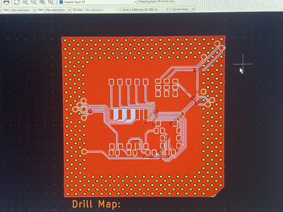

Reply 11 of 40, by Sphere478
still can't figure out why it shows drill holes in the wrong place at jlcpcb
I've gone through this with a fine tooth comb and nothing. either there is something I can't find or jlcpcb is glitching out.
If I paste one of the other project boards into the file and upload it, the drill holes go to the right spot, but transplanting this pcb into another file doesn't fix it. I'm really starting to think that this is a jlcpcb glitch.

Reply 12 of 40, by Sphere478
398.38 KiB
2191 views
Okay, apparently either they fixed it in review or it’s just a glitch when uploading. Becuse once it goes into production all is fine.

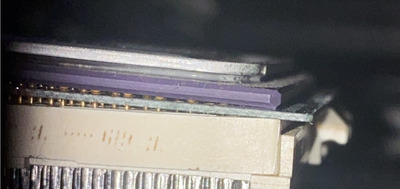

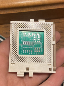

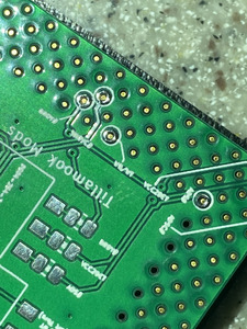

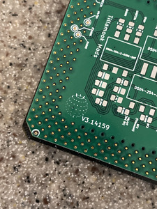

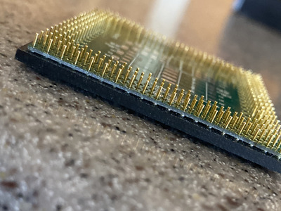

The fit on this is pretty good, but I don’t think it’s tight enough for press fit. (Press fit may not be possible.) for now, I think it should be assumed that to install these you need to solder them on
I’m gonna at this point say that the latest version can probably be considered usable. And out of beta.
It occurs to me that I could probably make a tillamook variant that solders to the top so that you can still see the markings below if you choose to solder it
The plastic pentiums are unique in that they have a ridge at the bottom of the pin, which makes the tweaker float a bit.
Reply 16 of 40, by Sphere478
Currently I don’t have the equipment to solder these on. So aside from inspecting and fitment checking that is all I will do at the moment. Also, I have hangups in regards to soldering to the pins of my cpus as a collector. But from what I can see I think this project is ready for members to start ordering if they wish.
Be sure to order .6 or .4 thickness.

Reply 18 of 40, by Sphere478
Good fitment
