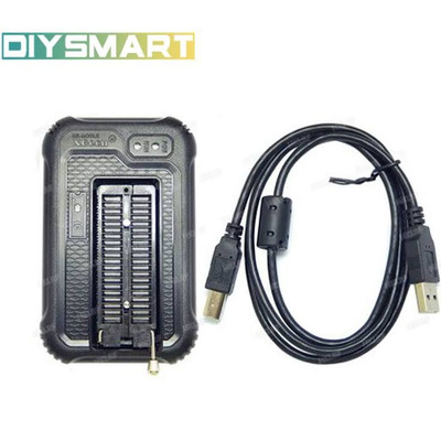

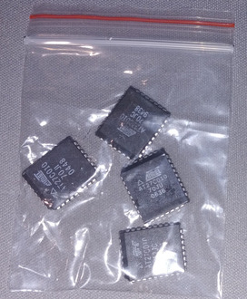

Reply 42 of 66, by dekkit
Replacement eproms
521.27 KiB
1514 views
T48 programmer
Got something like this with a bunch of attachments that fit the 27c010
44.91 KiB
1514 views
Now to google how to rip the eprom and hack video bios to CRT mode 😀

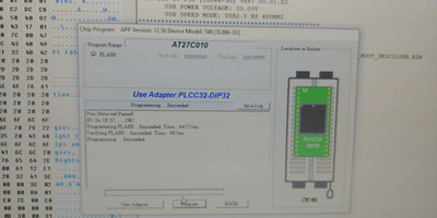

Reply 43 of 66, by dekkit
BIOS Extract using a T48 Programmer
Handy piece of kit - i was able to extract the real BIOS to start examining its contents.

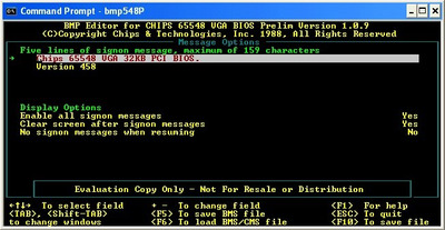

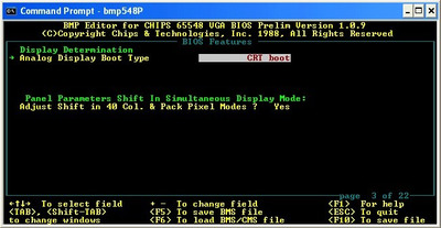

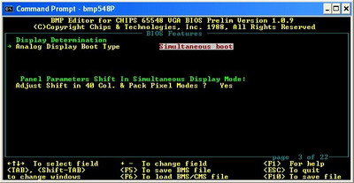

Reply 44 of 66, by dekkit
BIOS Hacking to Change Video Boot Mode
While i managed to get most of the way through it, my EPROM chips ordered from Aliexpress had already been written too - this isn't too great for chips that can only be written once - so i now need to wait for more parts 🙁
I believe I have found where the address in the bios file that defines if it will boot in simultaneous mode or crt only mode or flat panel only mode but i need verify if it will result in some validation error on boot (ie checksum check etc)
Understanding the VGA Bios
I was fortunate enough to find an OEM Video Bios editor (BMP548P) for this specific chip (it looks to be for a PCI card version of the video chip based on some settings but handy eitherway). This provided some excellent material to understand what was going on between setting options and what appears int he video bios file.
In examining the AT27C010 ic contents via a hex editor, i could also see the display text that the video card outputs near the start of the file, so initial signs were good - i could see where in the BIOS file - the vga bios information started and finished (using the previous vga bios extract), again good signs.
It is worth noting that absolutely none of the Phoenix editing tools i had found would work with the .bin extract! Nor did the OEM Video Bios editor (BMP548P) wanted to use vga bios bin i was able to extract from an earlier post.

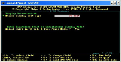

What i was able to do however was use BMP548P to help me discover where the display mode was being stored in the bios file.
When I started BMP548P inside a windows xp virtual machine, this is what it looks like. You see it immediately shows the boot message the user can edit:
61.99 KiB
1491 views
Pressing the 'tab' key a few times - took me to what i was looking for in the 'Display Determination' page.
As you can see its highlighted the defaults of:
- 'Analog Display Boot Type' option = Simultaneous boot
- 'Adjust Shift in 40 Col. & Pack Pixel Modes?' option = yes (which is the setting that is making weird refresh rates while the system is in simultaneous display mode)
A few further screenshots to highlight what options are shown.
54.4 KiB
1491 views
53.75 KiB
1491 views
53.7 KiB
1491 views
While i couldn't import my video bios settings into this application, it was able to save/ export was in BMP548P via pressing <F10>. This created a user specified .dat file - which on further evaluation under a hex editor was very similar to the vga bios extracted from the 486. Again good signs, as both appeared to be in a .bin format

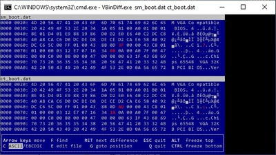

The next step was to see if i can use the export to narrow down the address of where BMP548P is saving the display determination.

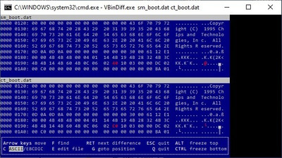

I did this by exporting 3 x versions of the BMP548P .dat file - keep all values the same EXCEPT the display mode.
- simultaneous mode
- CRT mode
- Flat panel mode
Then used a bin comparison tool (in this case VBinDiff-3.0_beta5) - this compares every value between two files and highlights any differences:
78.1 KiB
1491 views
This helped to identify 3 values that had changed between settings.
To narrow this down further, I exported the exact same settings (ie simultaneous mode) as 2 x different files - which should of resulted in two files being identical. Those 2 values as shown the picture above were also different despite all configuration settings being identical - the only thing i could think of was the difference in time between saving each file. Therefore i am assuming that these 2 values may either represent a date / time or some form of checksum using the system date and time.
Either way the 3rd value looked to be the location of the display determination.

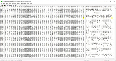

Narrowing it further, the setting looks to be saved at the Hex address:
Position = 0199
Comparing Hex values:
40 = Simultaneous Boot
c0 = CRT Boot
00 = FP Boot
The location is also the same in the T48 extract (with the values also appearing to align), so the next step is to order more ic's and test the theory.
525.14 KiB
1483 views
Getting closer....

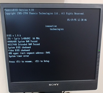

Reply 48 of 66, by dekkit
1.36 MiB
1422 views
And while I can now burn eproms...
Overall Outcome = Fail (for now) - see later post for update on how this was done.
With my new eproms I tried:
-Edited the single value and change (as per previous post) and burn eeprom
= video fail
No video, 2 beeps pc speaker, disk activty
(Repeated this test twice with another that overwrote some display text )
Copied the entire example crt video .dat into bios and burnt eprom
=video fail
(No video, no beeps but disk activity.
UPDATED 27/3 - the example crt.dat has an 8bit checksum =00. This would explain the lack of beeps ie it was considered valid even tho it did not show video output)
Burnt original eprom image to new eprom
=video works
Systems works as previous with same video issue (this was to rule out effect of new ic chips)
The positive is the bios backup works using the newer ic!

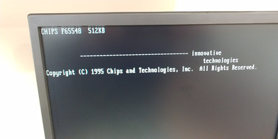

Reply 50 of 66, by dekkit
BIOS Modification - Success
After few failed attempts, success at last with glorious CRT mode now properly enabled in the bios at boot.
I replaced the description of the LCD panel that briefly flashes up on boot with the name of video chip and the amount of video ram and adjusted a few values to restore the expected checksum.
Its nice finally resolving this, particularly for entering the bios screens and not needing to rely on the dos programs at boot.
Here's what the modified video bios looks like.
632.42 KiB
1359 views
UPDATED to include pic of initial boot screen
261.42 KiB
1334 views
And here is the additonal ' junk' hex values in red that were inserted to balance the checksum to make it pass the checksum validation. I changed 2 x hex value near the end of the video bios:
00 to FF
00 to E7
1.59 MiB
1355 views

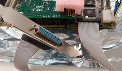

Parallel port (Printer etc) - Location
To complete mapping for this, HDR15 is the location of the parallel port pins (just below the CHIPS F82c735)
379.62 KiB
1293 views
Added pic of plug in socket (which i didn't include for the prototype)
1.5 MiB
1264 views

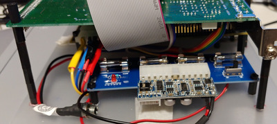

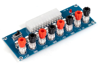

Power Supply - ATX Breakout board + cheap PICO PSU
To power the unit, i purchased one of these cheap ATX power supply break out boards off AliExpress and combined it with a cheap fanless 90W PICO PSU so i could run the whole thing off a 12v power supply adapter. I modified the breakout board to just use:
  • 5V
  • 12V
  • -12V
  • GROUND
Unscrewing the terminals and soldering a spare MOLEX cable directly to the board (to keep it from being bulky). These ATX break out boards are great for projects like this, even contain fuses, power led, and a power switch.
ATX Breakout
92.8 KiB
1276 views
PICO PSU + ATX Breakout + Molex + Switch wires
I wrapped the molex wires in color codes to make sure i didn't mix up, and soldered 2 x wires under the ATX board switch so i could extend a power switch to the front of the perspex case. I mounted the PICO and breakout board under the ISA sound card given the amount of clearance / space under it and given i'm using an external 12v power supply.
971.86 KiB
1276 views
I ended up buying a 12v 5A power pack but I don't think the board draws much at all as the 12v power pack doesn't create much heat all, other SBC from this era seem to draw 2.5A - but i haven't tested the power draw of it however it is very stable with 5A.

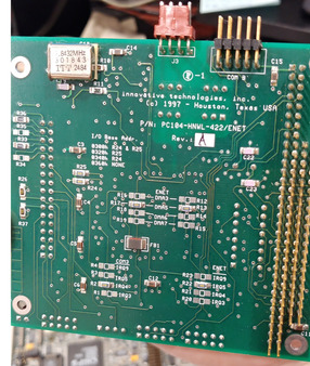

Reply 54 of 66, by dekkit
PC104 Add on Card - Network and extra COM port
While i'm including the remaining photos, i wanted to include a few details regarding this additional PC104 card that was specific to this SBC. Namely this included some clues to what some of the ports were (namely LEDS and Mouse) - as there are some parts of the pcb that re-use pins on the SBC. As mentioned earlier, the mouse pins didn't seem to register when connecting a ps/2 mouse and i ended up resorting to a ps/2 to serial converter.
This card adds:
- Base10 Network (J3 pins = Base10 Network)
- COM A and COM B pass through (COM A goes to another large IDC socket and COM B passes through to a COM B socket on the addon card.
- COM C (adding an additional 3rd COM port via the multi function IDC port)
- Multi Function IDC port (which includes COM A and appears to map the mouse pins)
While the BIOS and Windows 95 detects all 3 x COM ports, windows 95 also detected the network card (and automatically included drivers)- i could only get the COM ports working reliably - with the network pins not able to communicate (regardless how i reconfigured them). I suspect i might have either a hardware or driver conflict somewhere (DMA, IO address etc, or possibly the default win95 drivers isn't great for this card).
Given I've got all the functionality i need for now, i probably won't give this add on card too much more attention (that said if i do get the network working - i'll update this post).
Upperside of Add on Card
939.97 KiB
1270 views
Underside of Add on Card
964.52 KiB
1270 views

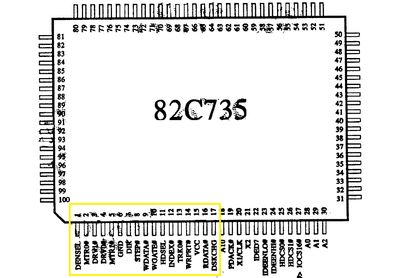

Reply 55 of 66, by dekkit
Floppy Port Location and Pinout
While I haven't used the floppy pins to connect a drive (given i'm using CF Card for IDE HDDS), I realised i haven't included the location or pinout from tracing through from the IC.
F82C735 Control Chip -Floppy pins
47.42 KiB
1262 views
Floppy Location
379.61 KiB
1262 views
Floppy Pinout
379.79 KiB
1262 views
