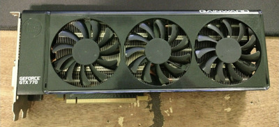

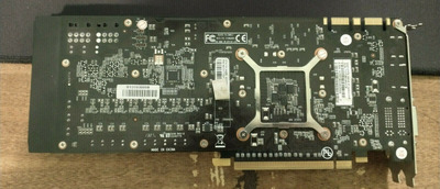

Hello, I bought for 30 bucks a gtx 770 which the seller claimed to give error when the driver were installed.
I've tested it on my x58 build and it gives the same problem (code error 43). Unlucky such error hasn't any clear solution.
The card itself seems to be in good condition, there are still the warranty seals so it means it hasn't be repasted or messed up.

Reply 1 of 8, by BEEN_Nath_58
I suppose the GPU is busted as you find garbage on the screen. Try out the oven method and see if it helps, but that won't revive the card for long as well.
Reply 2 of 8, by Nemo1985
I did try to reflash the bios, after that on desktop I had no issues, but as soon I started Shadows of Tomb Raider, the screen turned black after a brief moment and then huge rectangle appeared on the screen half black and half white, then garbage and in the end the screen has gone black again and the fans of the card started to spin at full speed.
I never solved any problem with the oven solution but I may try...
Reply 3 of 8, by The Serpent Rider
Palit/Gainward had trash GPU mounting. That bracket on the backside only increases chances of BGA failure, if cooler is heavy enough.
Reply 4 of 8, by Nemo1985
The Serpent Rider wrote on 2022-05-21, 11:46:
What do you suggest to try to revive it? Oven or heatgun?

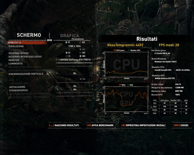

Reply 6 of 8, by Nemo1985
It lives, AGAIN! woooooooho 😁
I used the hot gun, I really don't like the oven method. I warmed the card at 80°C for 2 minutes and then 2 minutes at 250 and 1 minute at 300, I just heated the top part of the card, since the problem was propably on the gpu I focused on it but still gave a heat up to the whole card.
It's running fine (for now obviously) i'm just worried about the performance, which seems bad for the card model:
16.91 KiB
275 views
1.9 MiB
275 views
Are those results in line?
