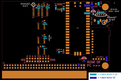

I've tested all that I currently can, with my basic meter and rudimentary knowledge. What I found, for whatever it's worth :
222.69 KiB
1420 views
I'm not too worried, I have spare parts to try again, and it was a good physical learning process.

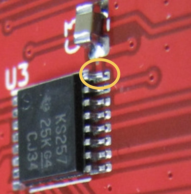

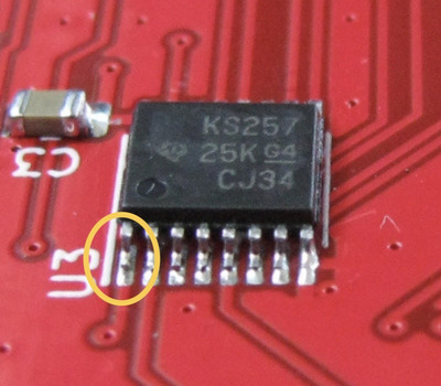

This all looks normal to me... I'm guessing you have a hidden solder bridge under the legs of one of the TSSOP chips. Have you checked that there is no continuity between all legs that are adjacent on the 3 TSSOPs?
Also, check these joints on the top edge of U3. It's hard to tell from the photos, but it doesn't look like they're fully connected:
    100.76 KiB
    1300 views
    155.13 KiB
    1300 views

GUS-like card detected. 😀
Many thanks for the pointers @MJay99 and @polpo ! I hit the card with a fresh set of eyes today, did the mentioned continuity tests, and refluxed and reflowed a few suspicious areas on the TSSOPs. It seems to have made the difference.
Time and further usage will tell if it's totally 100%, but I've just run (demoscene) Crystal Dreams II, Juice, and Unreal, and they sound great! Oh yeah baby.
