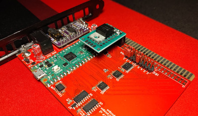

Problem statement: My GoTo DOS machine (SS7 MB with ATX power header only) has only 2 ISA slots. I'd like run my PAS16 with PicoGUS in order to have full (GUS, PAS, OPL3, SB) coverage. PAS16 needs -5V from ISA bus.
Old v1 PicoGUS PCB have empty ISA pinout holes. So I added pin header to PicoGUS in order to get access to -12V, -5V, GND for mini linear voltage regulator board (UA7905C) in order to provide -5V for ISA bus.
PicoGUS doesn't seem to use -12V and -5V pins so it should be safe.
PicoGus is capable to deliver many functions. Now we can add "voltage blaster" readiness to already extensive list 😉
    386.87 KiB
    1341 views
Reply 645 of 863, by polpo

vutt wrote on 2024-01-13, 16:54:
Problem statement: My GoTo DOS machine (SS7 MB with ATX power header only) has only 2 ISA slots. I'd like run my PAS16 with Pico […]
I love it! I'm glad I kept that header on the board as it's been cool to see people do interesting things with it, like using it as a faux PC/104 connector or what you've done!
