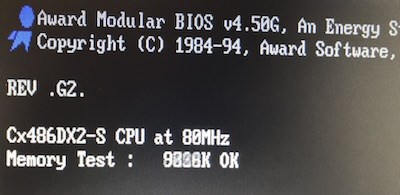

Reply 702 of 861, by digistorm

Reply 704 of 861, by digistorm
rasz_pl wrote on 2024-01-28, 17:30:
digistorm go into bios and play with ISA clock settings
Well. I tried to give it a go, although it is a complete pain because it sometimes takes 5 minutes before the demo crashes 😉
I have a Cyrix DX2/66 running at 40 MHz FSB making a 80 MHz effective clock. During these tests I had the divider at ⅕ making the ISA bus run at 8 MHz. I also tested it at stock settings (33 MHz bus, ¼ divider for 8.33 MHz bus speed) and the result was more or less the same.
Then I lowered the bus speed more and more: ⅙ (6.66 MHz) ⅛ (5 MHz) and 7.159 MHz fixed speed. I also tested it with de-turbo which should reduce the system clock to ⅓ of whatever is set, making the ISA run at 2.66 MHz. And the result was: the lower I put the bus, the earlier it seemed on average to crash. So not really helping…
Out of spite (😉) I then set the bus to ¼ or 10 MHz clock speed, expecting to it not even initialising. But WHAT IN THE WORLD!?
At 10 MHz, which should not even work according to the Wiki, it finishes the whole demo without issue (at least once, I was too fed up to repeat the test 😉). Also a quick run of DOOM2 confirmed that it too ran with an ISA clock of 10 MHz. Maybe there is something really fishy going on with this motherboard, I don't know…
Here are some pictures, I really had the ISA bus running at 10 MHz…
20.12 KiB
1291 views
27.35 KiB
1291 views
Well, maybe this gives some info? Maybe not 😊
EDIT: Could it be this motherboard is too slow or the PicoGUS is sending some kind of signal too fast for this particular motherboard to notice it unless it's bus is overclocked? This was not what I was expecting…
Reply 705 of 861, by rasz_pl
Sounds like PicoGUS needs a diagnostic mode where it does nothing (so no sound) other than listening to ISA Bus to determine timings. Clock speed, wait states, are all transitions happening at valid times etc. Run 'pgusinit.exe -diagnose', then run some game for a while so ISA bus get exercised, exit and rerun 'pgusinit.exe -report' to see what PicoGus thinks about ISA Bus. Basically Atheatos https://migronelectronics.bigcartel.com/produ … ng-device-v1-01 but on steroids, and cheaper 😀
Much easier to implement than logging while emulating GUS. Can even do pure logging to SPI ram so users of problematic boards can upload dumps instead of Polpo hunting for obscure hardware.
Reply 706 of 861, by polpo
@digistorm That's super interesting! Firmware v1.0.2 has faster assertion of IOCHRDY than previous firmwares, which means it probably actually can handle a 10MHz ISA clock. I haven't tested at that speed yet so the wiki still says 8.33MHz, but I want to see how fast it actually can go now. Now I need to think of why increasing the ISA bus speed would make the timer IRQ more reliable...
@rasz_pl that's a cool idea. I already want to add checking that IRQ and DMA work reliably to pgusinit to ensure people don't have conflicts and that their jumpers are set correctly... bus timing analysis would be another good thing to test.
