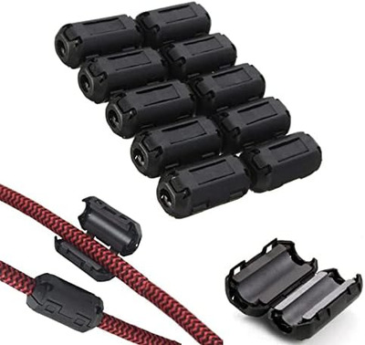

About modding the cable. That could be fun. Where to get the chokes the I do not have to cut the cable? Links or threads? I do not know what I should be searching for.

GF3 doesnt need DOS drivers, im not 100% sure about the DOS settings for the V2 but there are a lot of people on here that can answer that question. As for the chokes, I got mine from old crt cables, they are the kind that come apart so you can put them on the cable.
22.32 KiB
503 views
Ferrite Cable chokes
You can find ones exactly like this on Amazon, no idea if I can link Amazon here but https://www.amazon.com/ferrite-chokes/s?k=ferrite+chokes should get you started.
