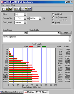

Reply 20 of 36, by Sphere478
Solo761 wrote on 2022-06-24, 08:00:
Issue here is lack od Win9x drivers for Promise SATA300 TX4 card, not maxing out speed.
90 MB/s I get on VT6421A is more than enough for P233 MMX and Win9x. But using Promise SATA300 TX4 card is different matter because of lack of Win9x drivers. You can install ones from Promise website, although they're Win2k/XP, but there won't be any improvement because it just "names" it, it doesn't actually install any drivers, so it ends up working in compatibility mode which is slow.
My numbers are in compatibility mode? Not saying you are wrong, I’m asking.
I haven’t been able to replicate the low numbers you are showing.
I’m looking in device manager, and you’re 100% right. It says no driver files are required for this device. But gives a date of 05/16/2007 and says not signed.
I guess the real question is, given the numbers I posted, how much of a speed bump would I get by going to a different card?
There is a section for command line parameters. Could we use this to set up the device better?

Reply 21 of 36, by Solo761
AKA DOS mode, or how ever it's called. No advanced features that would result in better speed if OS had drivers to talk "native" language.
Maybe it's combination of SSD and the card. So far I didn't manage to get more than 10 MB/s without drivers. If I install XP and then drivers it goes over 100 MB/s.
When I reinstall win98 today I can take a screenshot of same computer with Via VT6421A card, numbers are way higher.
I doubt any command parameters would work because there aren't any drivers to interpret them.

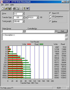

The Tx4 supports udma 133 via it's own bios extension (and udma33,66,100) in DOS. If you run the MEM command in realmode dos you will have 633KB free instead of 640KB as 7KB is used by the loaded bios extension.
Benchmarking in Speedsys on an ancient Pentium 75, Intel 430fx motherboard from 1995 I get 83MB/s using a 128GB SSD attached to the tx4. It's just limited by the PCI bus bandwidth and 32bit PCI slot, not the P75.
Using the motherboards own IDE controller I get around 8MB/s in DOS as it's limited to PIO mode 4.
Win98 in compatibility mode should default to using the TX4's own bios and then whatever UDMA mode the bios detects the attached drive being compatible with. All SSDs should be detect as UDMA133.
The only problem I can think of is unlike realmode DOS, Win9x is loading some useless driver (ESDI_506.PDR ? ) that is intercepting the cards bios calls and limiting it to PIO mode. Remove that and you should get 80MB/s + the same speed the card does in realmode DOS.

So you benched in dos? And got 83mb/sec? On a pentium 75? Wow very nice.
I’m a little rusty on the whole real mode/protected mode thing, last time I encountered it was in A+ cert in the early 2000’s 🤣.
So we can’t load a real mode driver or something with autoexec.bat or config.sys or whatever on windows boot? And have it set the card up right?

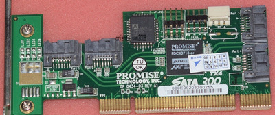

Reply 33 of 36, by Riikcakirds
Solo761 wrote on 2022-06-24, 22:25:
Just to be clear, are we talking about SATA150 or SATA300 TX4? There is TX4 card in both SATA I and SATA II variant.
The card is a SATA300 TX4, picture below.
191.24 KiB
753 views
This card is very fast in dos, realmode or protected mode (with emm386 loaded). Benchmarks at 83-87MB/s on a Pentium 75 with SSD attached in DOS7.1. No drivers like are loaded in config.sys and no tsrs in autoexec.bat
Win9x should do the same speeds in compatibilty mode (unless something is intercepting the calls to the bios on the card).

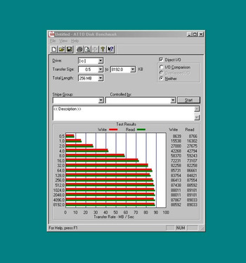

Here are the numbers of Via VT6421A card on already mentioned P233MMX + TX chipset system.
Card has three SATA ports and one IDE port, it's SATA I, up to 150 Mbit.
15.59 KiB
749 views

My card looks the same. Didn't try DOS benchmarks, only windows and those are the numbers I get. Windows are Win98SE, without any hacks or twists. Only VGA, LAN and audio drivers. No games or anything, built it few weeks ago.
Reply 35 of 36, by Sphere478
Riikcakirds wrote on 2022-06-25, 14:40:
The card is a SATA300 TX4, picture below. […]
Yep that’s my card sata II 300
