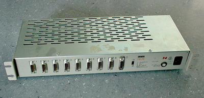

On the same desk or short row, or across a small room you can hook up the AUI 15pin D connectors in a "null modem" bodge between two 10b5 supporting cards.. https://www.epanorama.net/documents/lan/aui2aui.html
Reply 72 of 85, by davidrg
BitWrangler wrote on 2022-07-27, 01:57:
Yeah, I guess thats kind of what the DELNI does - its just a box with 9 AUI ports. Kind of like a hub from before hubs were invented. The ninth can be used to cascade to another DELNI (maximum three units I think?) or use an MAU to connect to the rest of the network.
173.11 KiB
748 views
DELNI picture from https://en.wikipedia.org/wiki/File:DELNI.jpg
