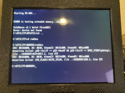

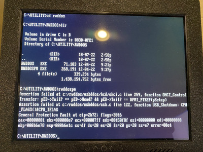

crazii wrote on 2022-10-07, 23:55:
sofakng wrote on 2022-10-07, 19:06:
OK - No problem... Thanks for the information. […]
However, I'm trying to use this on my weeCee x86 PC and when I plug the RetroWave into the PC, it causes the PC to reboot.
After the reboot, if I attempt to run RWDDOS.EXE it throws an assertion error:
After a few seconds, EMM386 also throws an error:
Sorry for the photos instead of screenshots.
Do you have any ideas?

Reply 22 of 37, by sofakng
Hmmm, it still doesn't work but I think the problem is between the Vortex86 (weeCee PC) and the RetroWave PotatoPi Lite. (ie. the RetroWave OPL3 is connected to the PotatoPi Lite)
As I mentioned, when I plug the PotatoPi + OPL3 into the weeCee, the PC immediately reboots. I've tried using a USB Y-splitter (for adding additional power) but it doesn't seem to help.
